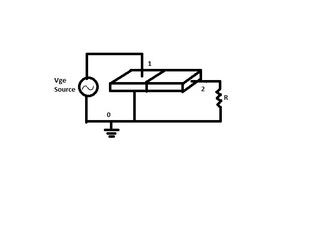

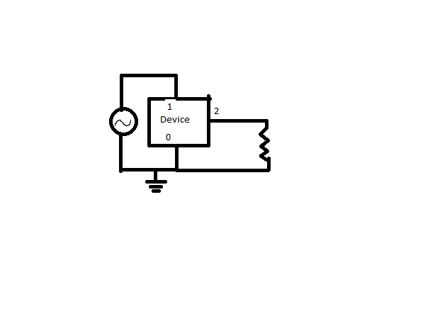

I have attached a small prototype of my design, the 'device' is my multiphysics model and i need to interface it with Electrical Circuit connections.
As per the diagram, in my physics model I have declared terminal 0 as ground. Terminal 1 and 2 are of the terminal type 'Circuit'.
In the Electrical Circuit (cir) node, I added a Ground node with node name '0'.
I added an External I-terminal 1 with node name 1 and Electrical potential as term1 (terminal voltage from drop down).
I added an External I-terminal 2 with node name 2 and Electrical potential as term2 (terminal voltage from drop down).
I added a Voltage source between node names 1 and 0 and Source type as AC.
I added a Resistor between node names 2 and 0 with value 100 ohms.
Is there any need to use External I vs U ? What mistake am I doing here ?
Thanks.

I checked all the connections, added the External I-vs U connections, I still get the same error 'DAE is structurally inconsistent. Error in automatic sequence generation'.

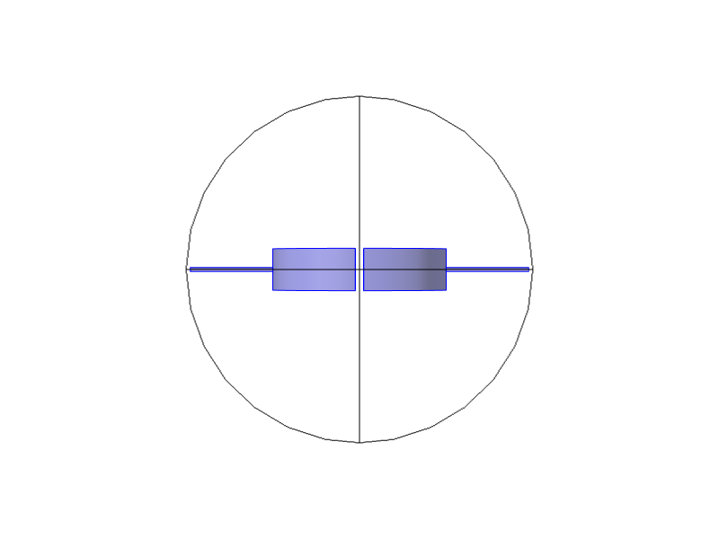

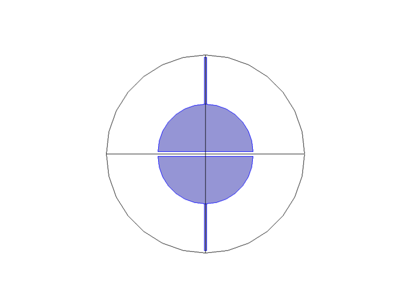

My device is basically a three terminal piezo transformer, where i want to apply an AC voltage to the input terminals for varying frequencies and connect a resistor at the output terminal. The input an output terminals have a common ground. The pictorial representation is as shown in the jpeg file attached.
And my model is as attached. After declaring the circuit connections, I am trying to do a Freq Domain study since I want to vary the input frequency to the transformer.
Any ideas what might have gone wrong? Thanks a lot!
Sneha

Sneha,
I rearranged your circuit nodes based on your .jpg diagram and how they made sense to me- although there are usually several "correct" ways rather than just the one . Seeing as your model has three terminals, and you need to define four in the circuit, I believe the two terminals need to share a node. External I vs U should be correct for both piezo terminals.
Let me know if the attached solution is what you were intending. Note: I ended up using MUMPS at the solver. PARDISO was default and was having convergence issues.
Thanks for sharing this problem, it is an interesting one. Do you mind if I ask the application?
Marc
