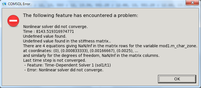

I included 2 more pictures. The first shows the error that I get when include the energy of combustion. I don't know why it says that it has found an undefined value in the stiffness matrix, but it just won't converge.

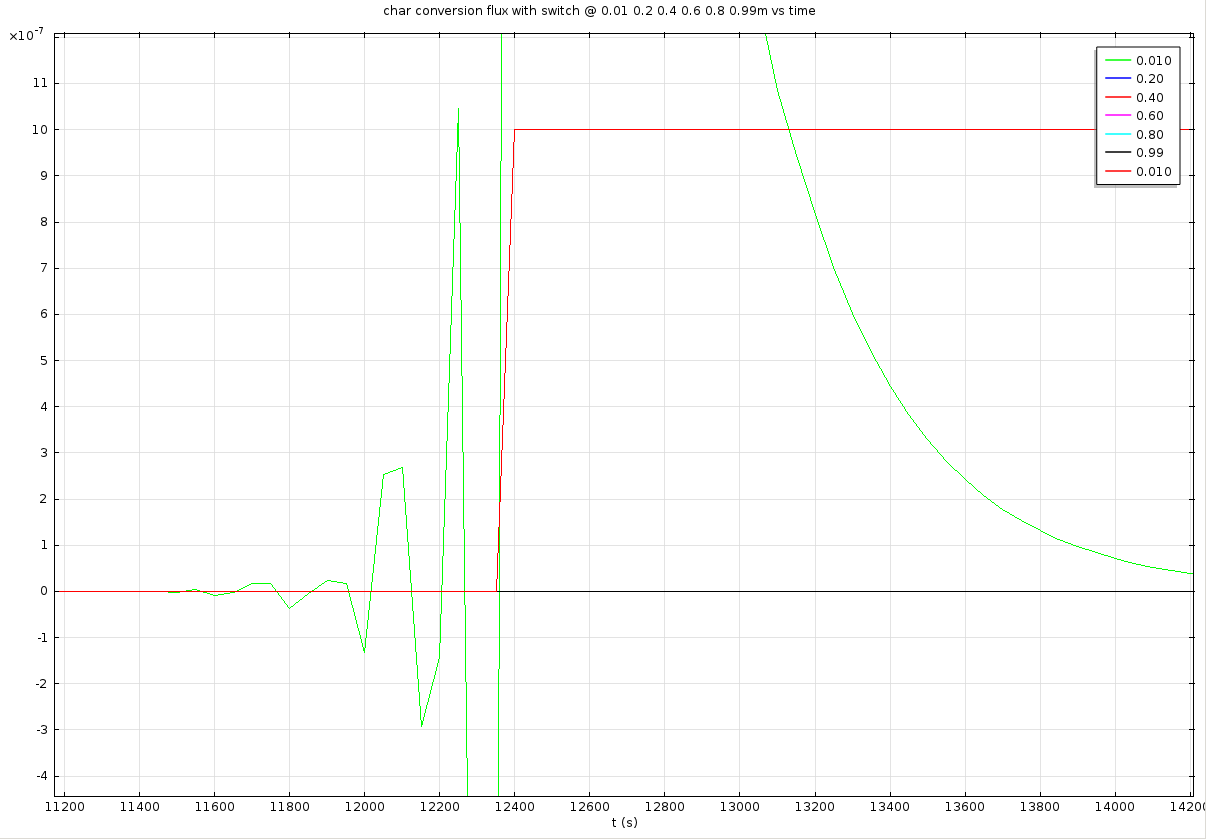

The second picture shows the amount of char left in a certain element. The amount decreases nicely as one would expect, but at the top small instabilities can be seen. These have the same origin as the instabilities in the flux plot, but where they come from...?
Please let me know if any of you have any suggestions or ideas.

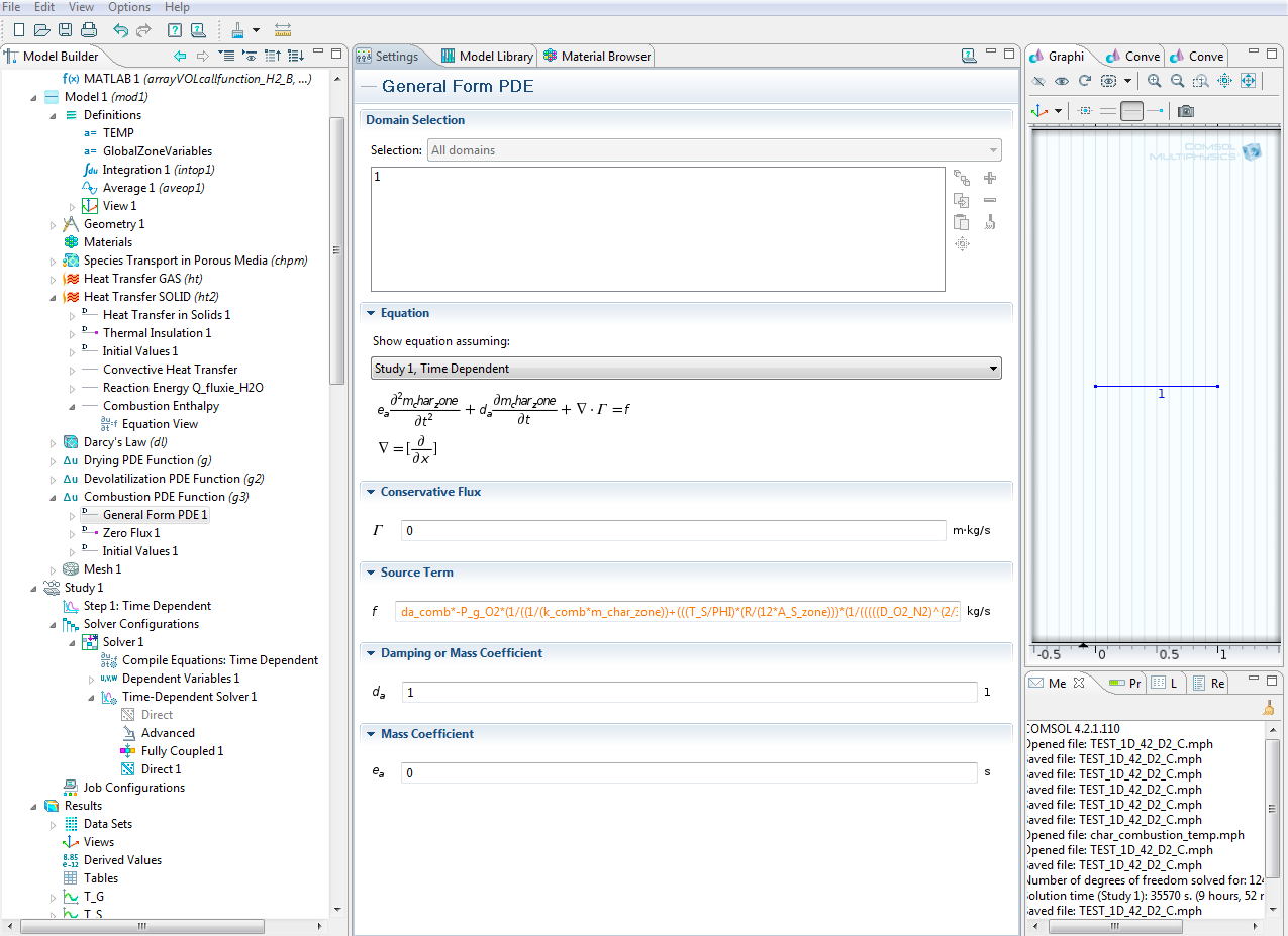

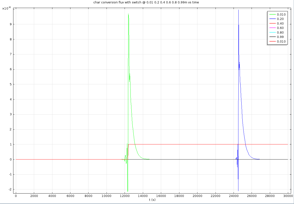

I am now sure that the oscillations happen because of the actual switching. Before I was thinking it could have been the combustion expression, but now I am sure that is not the problem.
To recapitulate: I have a PDE (general form) and I want to activate it (start using its expression) when the mass that is left (calculated by another PDE) falls below a certain value. This gives nasty numerical oscillations when the switching happens.
I tried to solve this by:
1) smaller timesteps (0.1 s, instead of 10 or 5)
2) more elements (3000 instead of 400, only makes oscillations smaller, does not remove them)
3) initial flux=0 does not work, initial flux = -1e-6 or -1e-8 solves but does not remove problems, or initial flux is taken the same as PDE function but with initial mass or that but with da_comb included, but these do not solve at all.
4) not use da_comb at all, but this does not work because the initial conditions of the simulation are not suitable for the PDE function, it has to happen later when the conditions are ok.
5) free BDF timestepping, intermediate, strict
6) quintic PDE shape function, hermite, discontinuous lagrange and setting all model functions to cubic.
7) make mu_gas, rho_gas, Cp_gas and k_gas constant as well as Cp_solid, k_solid
8) I tried making as many terms in the PDE constant, like this:
da_comb*-4800[Pa]*(1/((1/(1e-7*m_char_zone))+((1/0.08)*(400)*(R/(12*A_S_zone)))))
But this only seems to make it worse.
9) turned consistent stabilization on and off under the heat transfer modules
10) changed RelTol to 1e-6 and 1e-10
11) changes AbsTol to 1e-3 en 1e-6
12) used a smoothed step function to replace the switch, but this just makes the oscillations nice and round, but does not remove them.
13) Tried to make function dependent on temperature (instead of mass left) but this did not work either.
PLEASE, any suggestions? At all?
Thanks for the trouble
Ray.
PS. I included the model showing this behaviour (solves really quick).
The function of interest (da_comb) is under 'GlobalZoneVariables' at the bottom. The first graph shows the oscillation.
