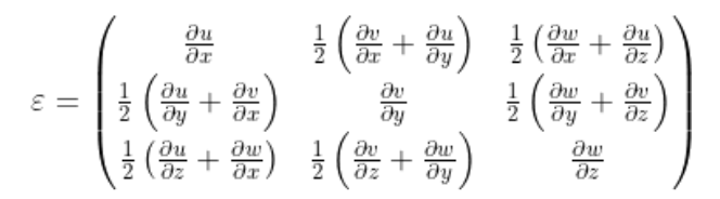

2) In one of the equations, I have to consider the time derivative of the strain tensor, that has the formula shown in "IMAGE_1" attached.Again, since I only have x- and y-directions, when I have to consider the time derivative of this matrix in comsol I type "uxt" for the first component, "0.5*(uyt+vxt) for the second component and so on.

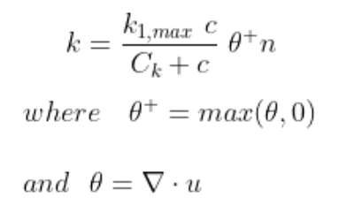

3) In one of the equations, I have the term indicated in "IMAGE_2", so when I have to write this in COMSOL I type "(k1max/Ck+c)* (n) * (max(ux+vy),0).
