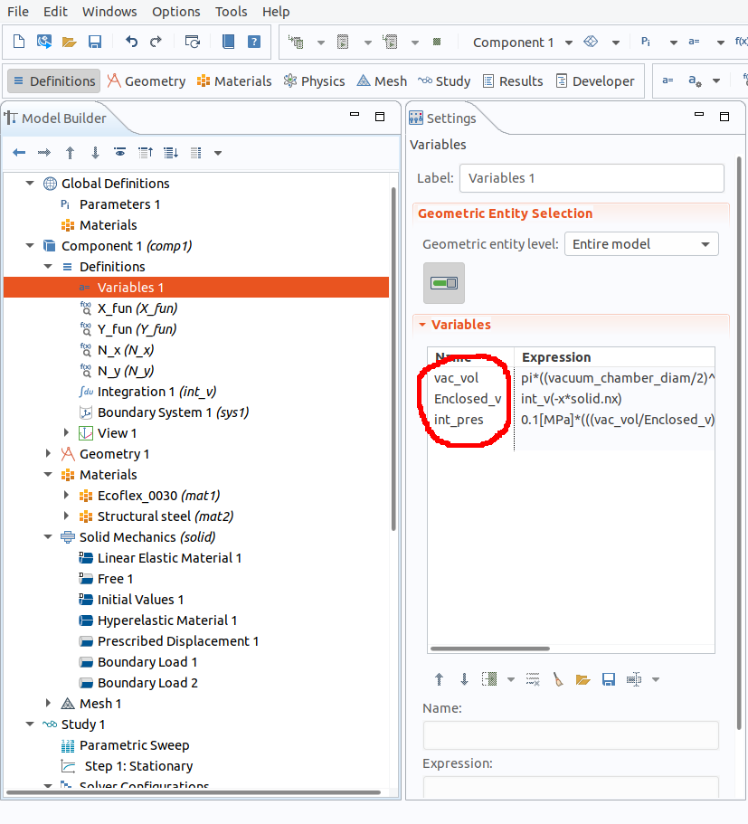

Hello, I have a question regarding variables used under Component, Definitions (see attached screenshot). I am using variables that change during simulation and are used as input for forces on the mechanical part. I am wondering if there is either a way to get the evolution of these variables as the simulation converges, or at least if there is a way to get the final values of these variables at the end of the simulation. In the Results section, I only seem to be able to obtain values that I can compute from the mesh, and can't seem to be able to either read / plot / obtain the values of these variables in any way. Any help would be appreciated. Best, Cedric

If your variables depend on x,y,z coordinates they are difficult to return as a number.
You can use probes to extract values from the model as numbers and plot them while solving.

Hi If your variables depend on x,y,z coordinates they are difficult to return as a number. You can use probes to extract values from the model as numbers and plot them while solving.

Hello, Thank you very much for your help! The particular variable I am interested in is actually a scalar (no dependance on axes). I could access it using the probes functions, thank you for your help! Best, Cedric
