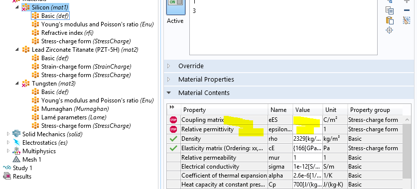

I'm trying to build a SAW resonator in Comsol, but I'm having difficulties in the material section.
As previously stated by others, Comsol allows only 21 coefficients in the elasticity matrix.
But Silicon, for example, has a different shape for the matrix and I can't modify it properly.
Am I doing some kind of silly mistake, confusing the matrix?
Also, if I will modify the matrix in the Piezoelectric Devices Physics section (Piezoelectric Material Model), will these modifications take place also in Materials Section of the Model?
Thank you.

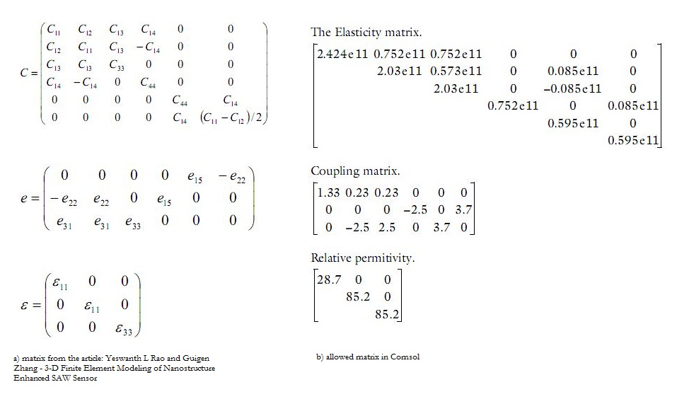

Nagi Elabbasi
Veryst Engineering
PS. It is the C-matrix the one I have to put in Comsol, right? The one that has c11,c12,c13,c33,c44 ?
Thank you!
How do I go from the elasticity matrix a), which is the one I find in the articles, to matrix b), the one allowed in Comsol?
Or, is there a different way Comsol defines this matrix?
Thank you,
Nagi Elabbasi
Veryst Engineering
1. coupling matrix, relative permittivity for silicon.
2. coupling matrix, relative permittivity, elasticity matrix for tungsten
