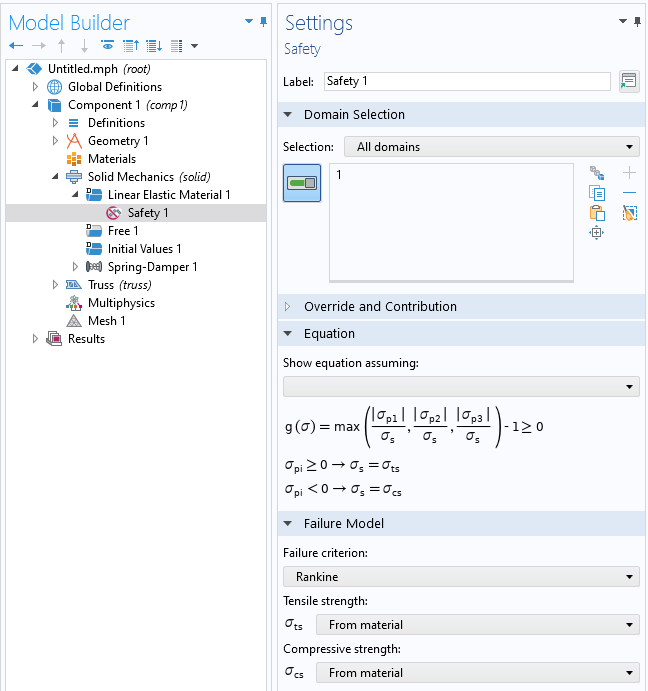

Posted: 5 years ago 22 ott 2020, 08:36 CEST
The Rankine criterion is built-in; see the attached screenshot.
