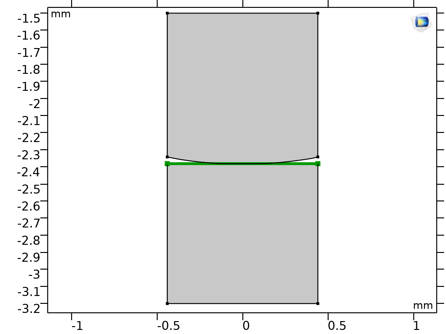

Hi.I'm modeling a contact problem between two surfaces in a 2d problem as shown in the attached figure. I cannot get the data because i got this error: "Wrong dimension of points searched for in postinterp." i use mph inter as shown below:
mphinterp(model,'solid.Tn','coord',nuevoxy,'edim','boundary','selection',4)
where nuevoxy is an array with the coordinates x and y of the points in the boundary where i wanna get this data.!

Most likely you need to use nuevoxy' instead of nuevoxy. Coordinates in Comsol are columnwise.
Lars
Lars Gregersen
Comsol Denmark
Hi Yesinia Most likely you need to use nuevoxy' instead of nuevoxy. Coordinates in Comsol are columnwise. Lars
