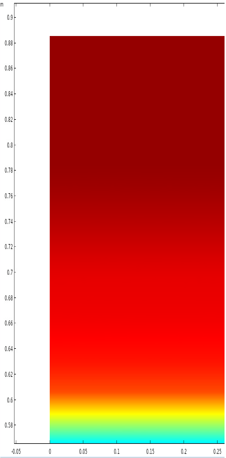

I have model regions which are very thin and long and have strong complex gradients along the shorter side.
How can I scale one of the two axes of a 2D plot (see illustrations attached)?
Opposite to a 1D plot (a curve y = f(x)), where any axis can be easily squized or expanded, the axes of a 2D plot (for example, field as a function of (x,y)) are always shown in the actual scale, equal for both axes. I have tried slices of 3D plots, 2D plots on various options of "Datasets", etc., but none of them worked in the way I want.
It would be very strange if COMSOL cannot do such a simple thing. Now I have to export and plot in an external software every single field distribution just to be able to see the solution result.
