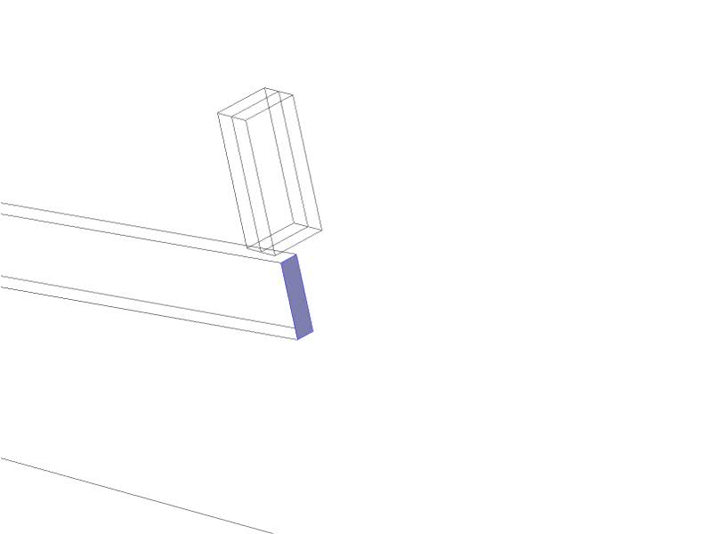

Another question came into mind. Since for my geometry, the bottom wall of the duct lies at z=0, once i offset the z up away from the bottom boundary, will the wall function still apply right after the bottom boundary at the start of the duct?
Picture description:
The highlighted rectangle is the applied inlet where my previously defined U_profile is placed. The bottom line of the highlighted boundary is z=0.
