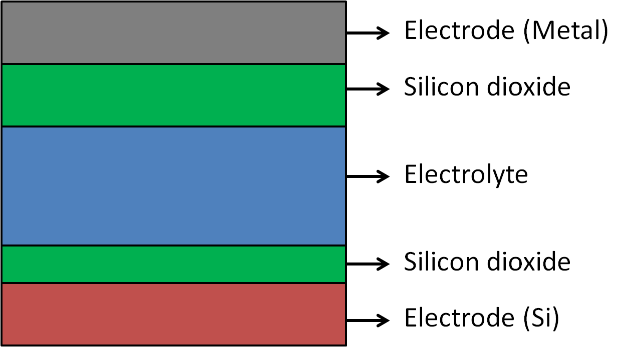

                                                    I am attaching the revised model. I took care of the units...sorry, it was a careless mistake. I guess I really need help with the physics...the potential in the electrolyte in the result becomes much higher than the applied voltage...and I feel it is not correct because the charge density term doesn't use the correct potential and it ignores the second interface.
The top domain is oxide, then electrolyte, then oxide and then silicon. The top and bottom boundaries of the stack are applied potential and ground. I have defined 3 Poisson equations. The oxides are assumed to have some internal charge. Si is modeled with internal depletion charge. And I have used the modified Poisson-Boltzmann equation for the electrolyte. I am using the equation described in the attached comsol conference paper. I also double checked the equation with Kornyshev's paper titled "Double-Layer in Ionic Liquids: Paradigm Change?"...he actually acknowledges you in that paper! I keep checking my equation and it is correctly input and matches the equations in those papers...but I get a strange result. Could you please take a look?
I also have these key questions:
1) What about the other double layer at the second interface (bottom oxide-electrolyte interface)? The charge density defined for the electrolyte domain using any double layer equation is defined dependent on the surface potential at an interface...so the equation is technically only valid for one interface.
2) Due to the top oxide dropping some of the applied voltage, the charge density term in the electrolyte is actually wrong because I use Vapp. In reality it should be the potential at the top oxide-electrolyte interface, which is only calculated after the potential drop in the top oxide...so how do I do that?

                                                    No, I don't think its me who mentioned in Kornyshev's paper. I don't know him personally. Just a coincidence, I guess :)
You improved your model but still didn't do it as I suggested in my previous message. I believe that after you do so, you should be getting something very close to real situation. What you have now is wrong in several places.
And again, make sure you completely get rid of those yellow-highlighted expressions by using correct units.
To your questions:
1) You charge density in entire electrolyte domain should be defined as sum of two exponents: exponent for positive charge at one of the interfaces and exponent for negative charge at the other one. Both exponents are function of distance y.
2) Potential drop in oxide should be pretty small in your geometry. First, I'd ignore it. Then define a variable for potential on electrolyte surface and solve two coupled equations using it.

                                                    Sorry I keep asking so many questions. I'm very new to both comsol and electrolyte modeling...and there is a big disconnect between what I need to do the develop the model and what I read in papers...so I'm learning as I go. I've been trying to follow papers until now...I've read about 10 of them...all of them are only concerned with one interface and so they only include one charge in their charge density term...I guess this is exactly where the key difference is. I'll try with the charge density term including both charges.
1.) But I'm afraid I still don't know exactly what you mean by the exponents being a function of distance y...I've never seen that in papers. I suppose its a special condition for me because of the 2 interfaces and the fact that I'm trying to use the double layer equation for the WHOLE electrolyte? Do you mean include position "variables" in each exponential so I can pre-define where they go to 0, so that at one interface one of the exponentials always goes to 0? Like below?:
charge density in electrolyte = ((q*z*N*Cb) / (eps0 * epsrwater))* (exp1+exp2) [N = avogadro's number, Cb is bulk ion concentration]
exp1 = exp ( (q * Vapp * Pos1) / (k*T) )  -> exponential for top oxide
exp2 = exp ( (q * VIntf2 * Pos2 ) / (k*T) ) -> exponential or bottom oxide
Pos1 = 1 and Pos2 = 0 at top oxide-electrolyte boundary
Pos1 =0 and Pos2 =1 at bottom oxide-electrolyte boundary
OR can you provide a reference where I can read about this approach?

                                                    1) charge density in the electrolyte is given by c1*exp(-(y-y1)/c2)-c3*exp((y-y2)/c4) , where constants c1-c4 depend on the properties of your electrolyte and y1 and y2 are the coordinates of two boundaries. What you are writing is the charge density at one point (at the interface).
2) I believe the best way will be to use coupling variables for that. There are plenty of discussions on the forum about using them.
