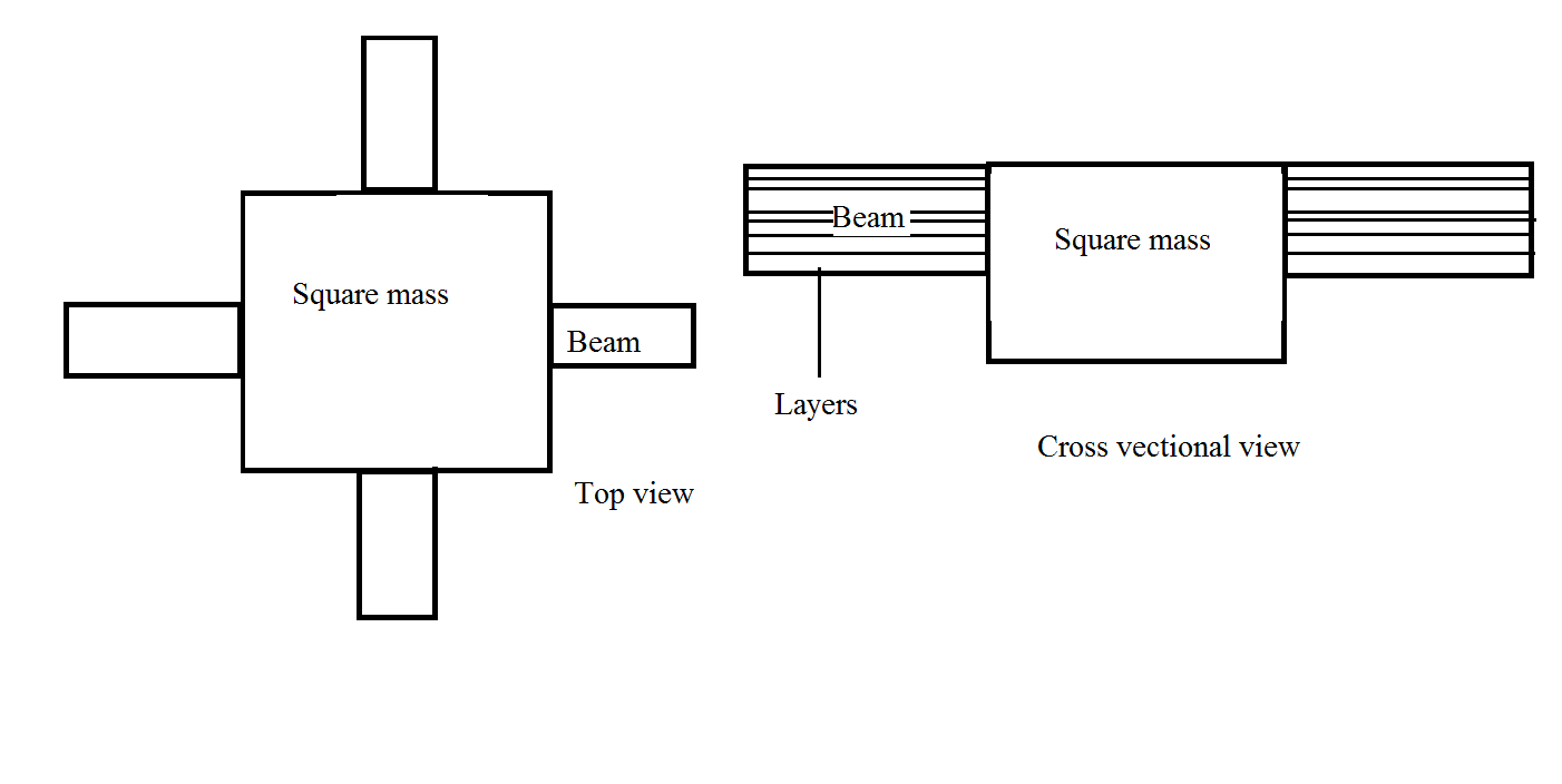

Looks like meshing is a real 'art'. I have attached schematics of my model. All the layers in the beams are attached to the square mass. I tried meshing (sweep) the square first and then meshing the layered beams. No luck.
Tried sweeping layers, converted them and then meshing square mass (both sweep and tetrahedral). Did not work.
Tried to sweep from sides and then meshing the square mass. Did not work either!!
Is there anything left to be tried?
Sankha

are your x-y scales isotropic or are the beams very thin ?, one way would be to cut the square at the height of the lower beam boundary, mesh the beams with tri on top and sweep through, then convert the surfaces = boundaries como to the upper square and try toget that one into a fine thet, you should allow for small mesh, reduce the minimum size to about the value of the smallest mesh in the beam section. Thereafter you mes the lower part of the square with a normal thet mesh.
Another way that works 100% but generates very man mesh elements, is to cut the square block along all the layers of your beams, so you have a full transverse "lasagne" plate there (hope you know italian cuisine ;) then you can mesh the full top surface with tri and sweep through the rest of your parts all the way down. You might want to add several dimensions and ensure you have a few layer per layer thickness
Hi are your x-y scales isotropic or are the beams very thin ?, one way would be to cut the square at the height of the lower beam boundary, mesh the beams with tri on top and sweep through, then convert the surfaces = boundaries como to the upper square and try toget that one into a fine thet, you should allow for small mesh, reduce the minimum size to about the value of the smallest mesh in the beam section. Thereafter you mes the lower part of the square with a normal thet mesh. Another way that works 100% but generates very man mesh elements, is to cut the square block along all the layers of your beams, so you have a full transverse "lasagne" plate there (hope you know italian cuisine ;) then you can mesh the full top surface with tri and sweep through the rest of your parts all the way down. You might want to add several dimensions and ensure you have a few layer per layer thickness -- Good luck Ivar

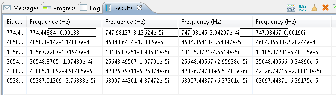

Earlier I was using Solid mechanics as the driving physics for Eigen frequency analysis. I was getting error ' Failed to evaluate variable Jacobian '. Now I use Piezoelectric devices as the driving physics. Well, I do not get any error, but get imaginary frequencies.
All I am trying to model is a layered resonator which has (unfortunately!) a piezoelectric layer! Which physics should I select? How do I make Comsol understand that ZnO is a anisotropic material (has elasticity matrix) where as rest of the materials are isotropic material (has Young's modulus and Poisson's ratio) !!!!!!!!!!!!!!!!!
Sankha
Hello, Earlier I was using Solid mechanics as the driving physics for Eigen frequency analysis. I was getting error ' Failed to evaluate variable Jacobian '. Now I use Piezoelectric devices as the driving physics. Well, I do not get any error, but get imaginary frequencies. All I am trying to model is a layered resonator which has (unfortunately!) a piezoelectric layer! Which physics should I select? How do I make Comsol understand that ZnO is a anisotropic material (has elasticity matrix) where as rest of the materials are isotropic material (has Young's modulus and Poisson's ratio) !!!!!!!!!!!!!!!!! Thanks Sankha
Posted: 1 decade ago 2 mar 2012, 01:45 GMT-5
1) complex eigenfrequencies means you have damping i.e. probably from the PZT ircuit, and you should get different frequency results for short and open circuit PZT
2) if you hve a combination of slid and PZT you need to add a second (or more) linear elastic material sub-nodes ,one for the isotropic, one for the anisotropic per orientation
3) normally you should not mix SOLID and PZD physics, as PSD cover SOLID already (+ parts of ES/EC + PZT materials physics)
Hi 1) complex eigenfrequencies means you have damping i.e. probably from the PZT ircuit, and you should get different frequency results for short and open circuit PZT 2) if you hve a combination of slid and PZT you need to add a second (or more) linear elastic material sub-nodes ,one for the isotropic, one for the anisotropic per orientation 3) normally you should not mix SOLID and PZD physics, as PSD cover SOLID already (+ parts of ES/EC + PZT materials physics) -- Good luck Ivar

for me a complex eigenfrequency should be seen as a phasor (amplitude and phase) indicating that the response is dephased w.r.t the excitation (you also observe this if one look at the eigenfrequency metallic beam with damping).
The reason why a PZT changes frequency physe in open and closed circuit (charge acumulation and charge exchange) is that the PZT charge generated from the bending of the beam interacts with the bending motion (and differently in charge accumulation and charge exchange mode)
Hi for me a complex eigenfrequency should be seen as a phasor (amplitude and phase) indicating that the response is dephased w.r.t the excitation (you also observe this if one look at the eigenfrequency metallic beam with damping). The reason why a PZT changes frequency physe in open and closed circuit (charge acumulation and charge exchange) is that the PZT charge generated from the bending of the beam interacts with the bending motion (and differently in charge accumulation and charge exchange mode) -- Good luck Ivar

I do not understand why you want to remove this additional information, that is due to the material proerties and the way you drive your device. For me these are essential and part of the model.
If you want to have a real value to work with, use the "phasor" notation and separate the amplitude and phase
lamb = lamb_r + i*lamb_i = sqrt(lamb_r^2+lamb_i^2) * exp(-i*atan(lamb_i, lamb_r))
see also the web with "phasor Wiki" and "phasor Wolfram"
For me there is no reasons neither mahematical nor physical why the eigenfrequencies should be only "real"

Hello Ivar,
It's good to hear from you. I had almost given up on the frequency analysis of my model. But now I feel like trying again. I have done Eigen frequency analysis of my design and have got consistent results. I have used the material properties from the COMSOL materials library. I have used extremely fine mesh and have tried Frequency sweeps close to the resonance frequency and far away from resonance frequency. What I have not done are the followings-
1) Stationary study 2) Have not used "enough damping denied". While I understand statioary study, I do not understand "enough damping". Could you write in short what do you mean by enough damping and how to implement that in Comsol. I think that might work.
Sankha
