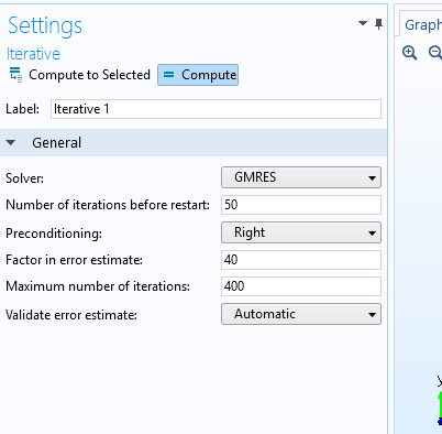

Ill conditioned preconditioner and increase the estimate factor.

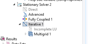

Try changing the preconditioner factor in iteration section of the solver configuration where this warning or error has occured. One can try increasing the error factor as well.
