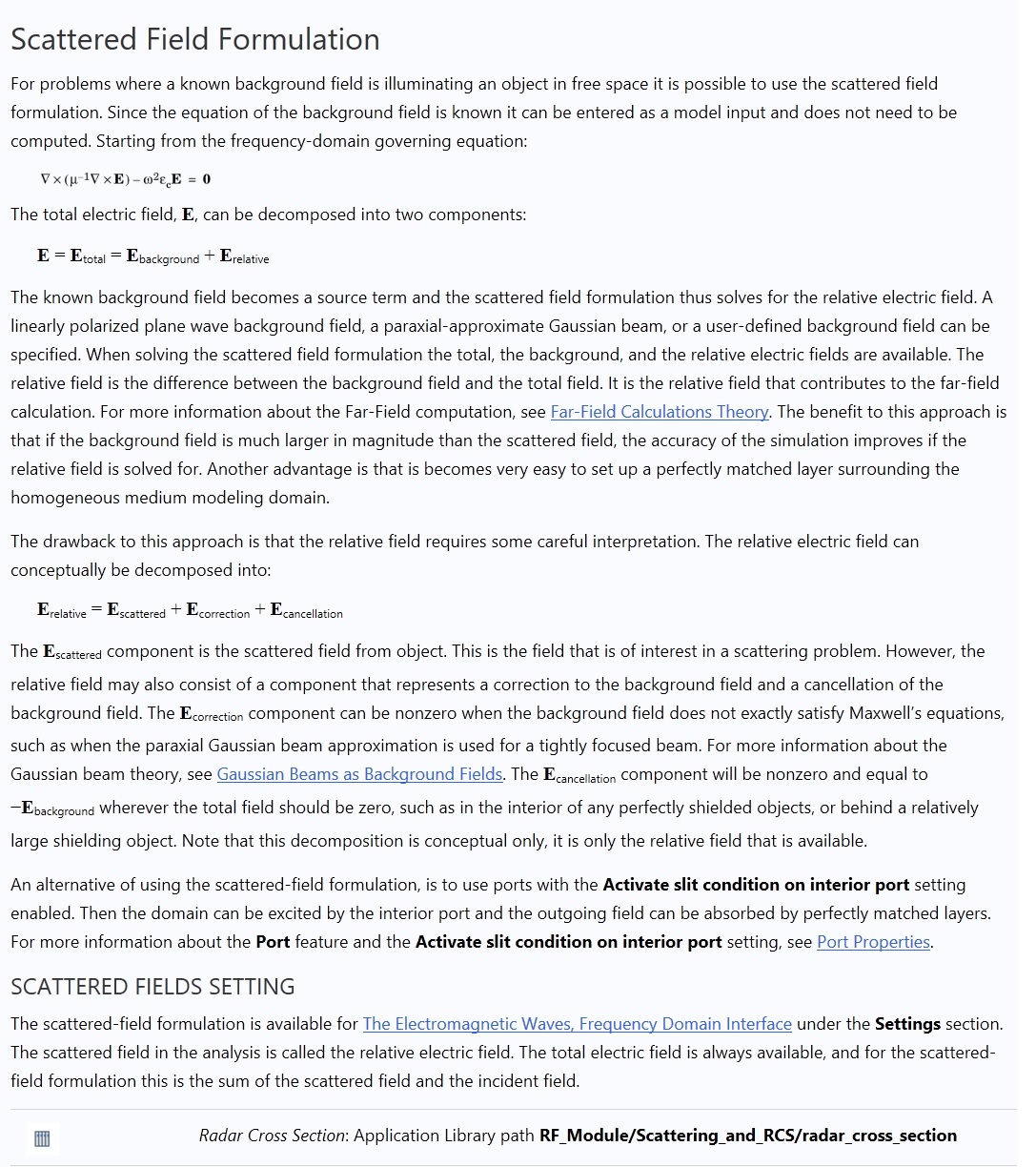

The impedance boundary condition is not the right boundary condition for launching a wave. It represents a material. In your case, it was air. It is as if you wanted to launch your wave both upward and downward at the same time.
The scattering boundary condition can be used to launch a wave, and (if I recall correctly) was the method of choice roughly 15-18 years ago. But it is usually not the best way to launch waves nowadays. Consider using the "scattered-field formulation." The attached is from the help system:
The impedance boundary condition is not the right boundary condition for launching a wave. It represents a material. In your case, it was air. It is as if you wanted to launch your wave both upward and downward at the same time. The scattering boundary condition can be used to launch a wave, and (if I recall correctly) was the method of choice roughly 15-18 years ago. But it is usually not the best way to launch waves nowadays. Consider using the "scattered-field formulation." The attached is from the help system:
