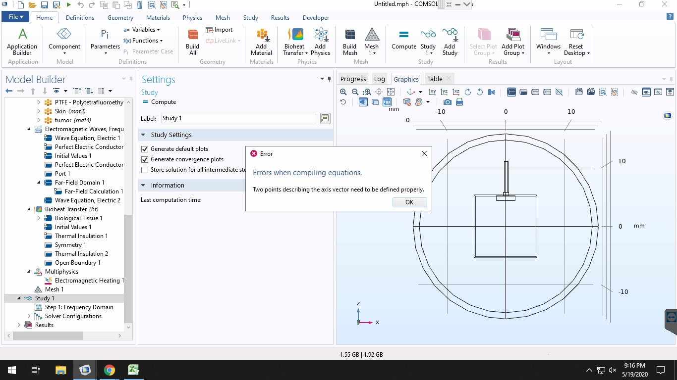

Hi, I am Rahma. I've made a structure for microwave heating. But i found a problem, it can't be computed because of the axis which need to be defined. I don't know which axis that requested by my simulation. Can you figure out based on your experience and knowledge about my problem? I attach a pict for my problem.
Thanks regars, Rahma

This can happen if you have a circular waveguide port. In that case you need to define the direction of the electric field.
If that's not it- then post the model.
This can happen if you have a circular waveguide port. In that case you need to define the direction of the electric field. If that's not it- then post the model.
