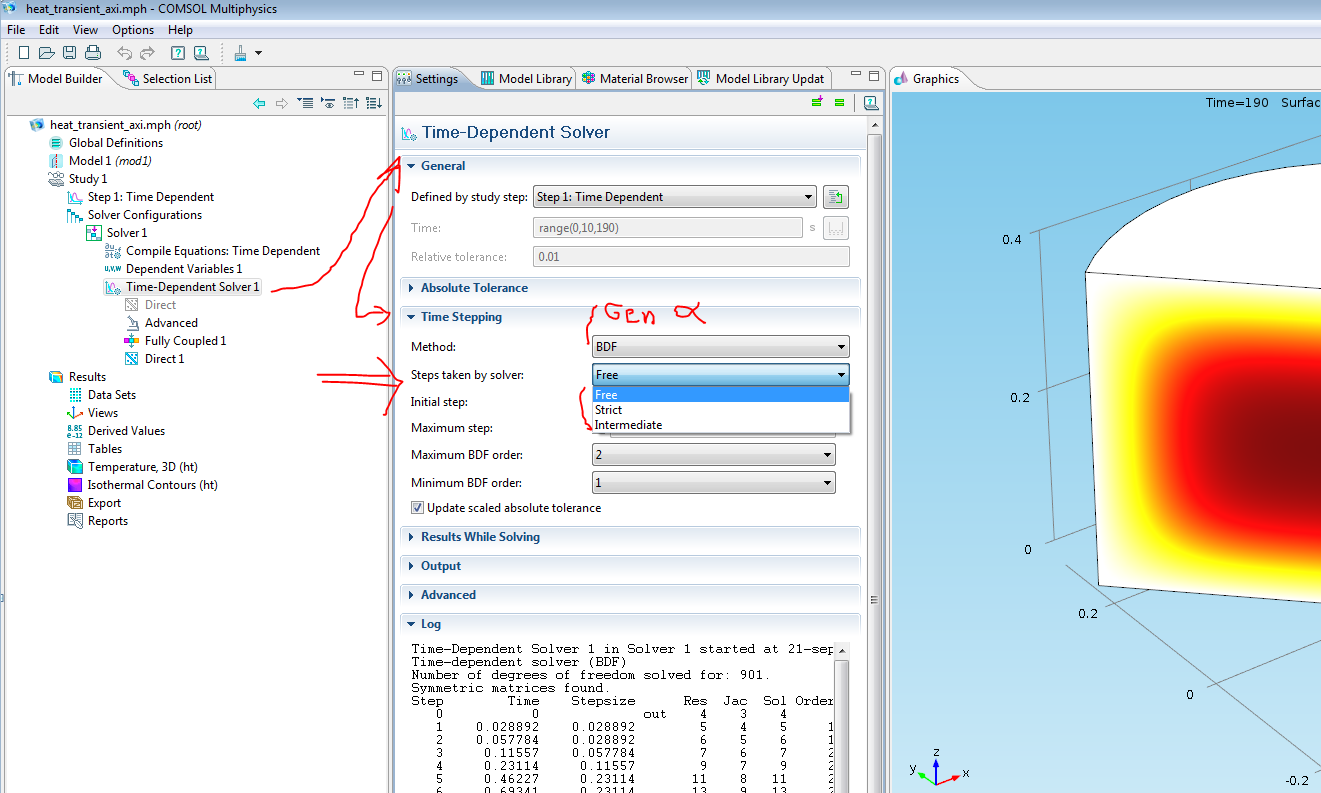

Is it going to do any good ?? if i have not mistaken ... anyways .. just see the image !
PS:
sry i am poor in paint ... nvm !
Is it going to do any good ?? if i have not mistaken ... anyways .. just see the image ! PS: sry i am poor in paint ... nvm !

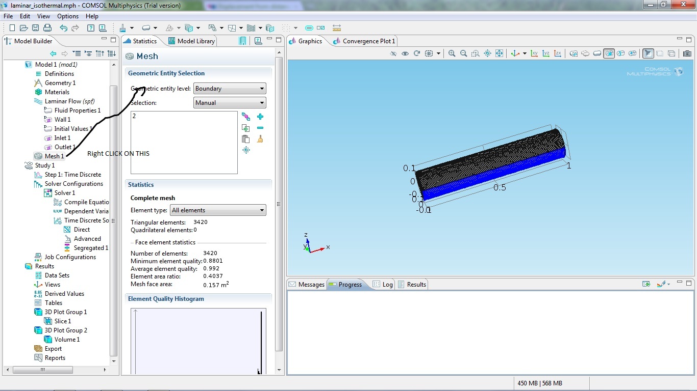

Sorry for the wrong image i have attached ..
Simply right click on mesh and select statistics and change what you want to select for from the drop down list boxes .. "geometric entity level" and "selection"
Sorry for the wrong image i have attached .. Simply right click on mesh and select statistics and change what you want to select for from the drop down list boxes .. "geometric entity level" and "selection"

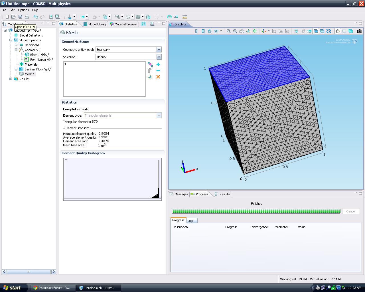

The image that i intended to attach !
