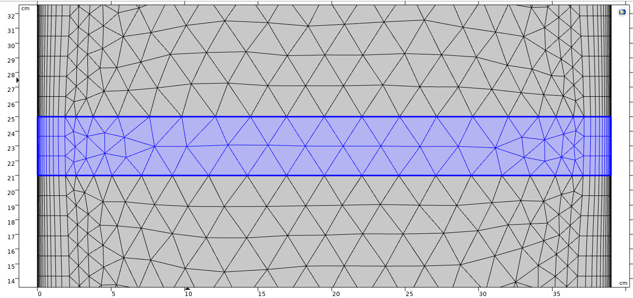

I’m doing simulation of airflow through porous media. According to the characteristics of the flow and the geometry, the flow is turbulent, so after doing some simulations, the physics chosen was k-epsilon Low-Re, because of the wall treatment (Low Re). Geometry is a 2D rectangle representing a long tube with the porous bed in the middle of it.

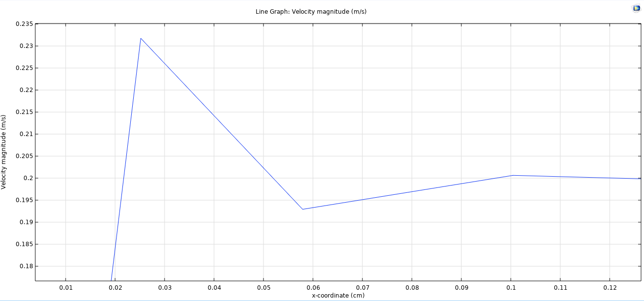

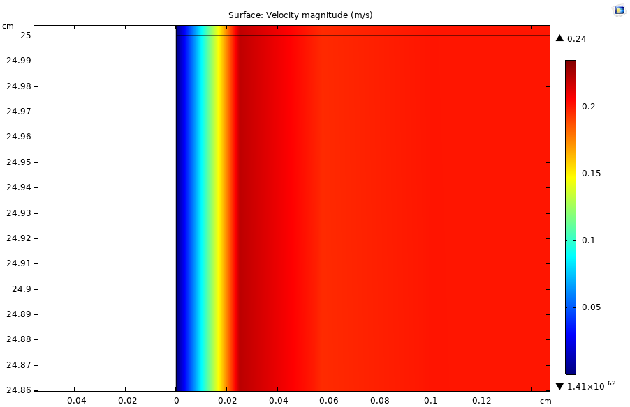

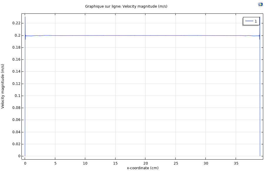

So, when I defined a horizontal cut line in the middle of the bed to see velocity profile, I found a problem because a velocity peak is shown at each side, near to the wall (fig 2 and fig 3). Since properties are isotropic, there no reason for this, so, there is something wrong.
I think it is not a boundary layer problem because I simulated it when having a fully developed flow and with 12 boundary layers (as default), shown at fig 1. Minimum mesh quality is 0.45, which I think is not so bad. I tried also using laminar flow conditions and Fluid and Matrix Properties as default which uses Darcy's Law, but the profile was similar.
