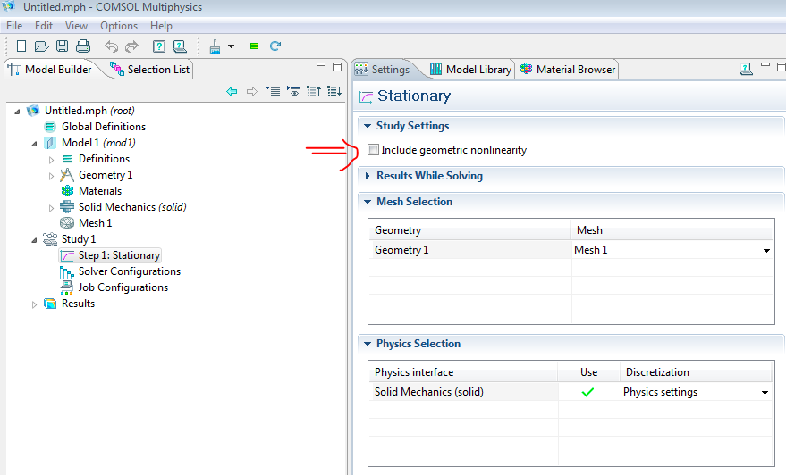

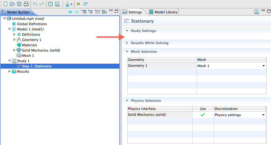

I have an odd problem. I am trying to recreate the Large Deformation Beam model (www.comsol.com/showroom/documentation/model/204/) before I start my own project to investigate buckling. I was following along with the model, but when I go to Study 1 > Step 1: Stationary and open Study Settings, I do not see any buttons that say "Include Geometric Nonlinearity". Indeed, I do not see any buttons at all.
When I download the support file for the Large Deformation Beam model, I do see this button.
However, if I delete the stationary solver and add a new one, I do not see the button any more.

I do (if I select solid, it depends on the physics (also .166 on Win-7)
Hi I do (if I select solid, it depends on the physics (also .166 on Win-7) -- Good luck Ivar
Posted: 1 decade ago 3 feb 2012, 17:39 CET
I don't (even when I select solid, on a Mac)
-jfb
Hi I don't (even when I select solid, on a Mac) -jfb

Are you sure you have the Structural Mechanics module, or one of the other modules that support nonlinear structural analysis?
Nagi Elabbasi
Veryst Engineering
Are you sure you have the Structural Mechanics module, or one of the other modules that support nonlinear structural analysis? Nagi Elabbasi Veryst Engineering
