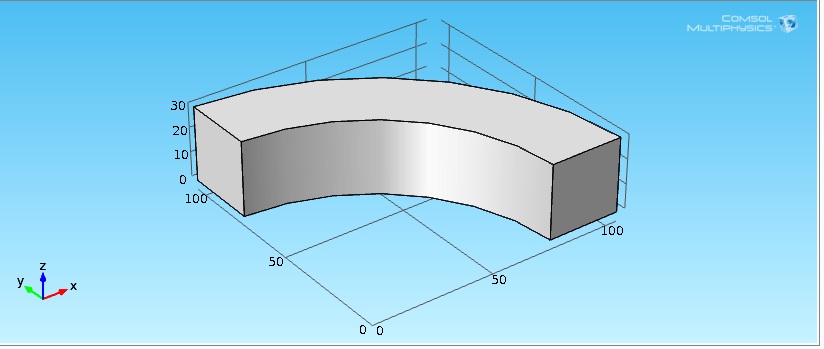

I am Akshay, a student of Mechanical Engineering. I am using COMSOL 4.2 for my research in Microfluidics, and am currently working on the numerical simulation of a purely Electro-osmotic flow in a curved channel, that is a quadrant of an annulus between 2 cylinders. The flow simulations for my research require the streamline contours of the flow in the cross section of the channel. But I am right now able to plot the streamlines only along the axial path of the channel, that is along the circumference. Although I am getting the results correct, they are of a lesser importance to me, since I need to capture the formation of flow circulations in the c/s of the channel.

I want to capture the streamlines in a cross section such that they will be generated only by the velocity components normal to the flow direction along the circumference. But the flow being 3-Dimensional, there exists an axial component too. Can such a generation of streamlines be possible ?
When I attempt to plot the streamlines in a 3D plot group format, I use the "selected boundaries" option. But to obtain in a cross section, I need only the 2 components. So I tried by defining the axial component to be 0, but still it being a 3D case, I am getting streamlines all along the flow, which I do not wish to have.
I also tried to plot them in a 2D plot group format, by representing only the normal components to the flow direction, but the plots require a surface to be defined. i right now have only the confining surfaces of the geometry, but I need a surface in the domain, that will be at an angle to the X-axis, normal to the circumferential direction. How do I generate plots in that case, if no such surface exists ? If I have to define a surface i.e. a boundary inside the domain, how do I do it ?
Akshay
For your referenc,e I am attaching the image of the geometry file herewith.
Thanks again,
Akshay
