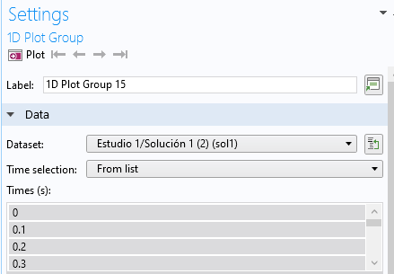

I have written 0.025 s as time step but comsol plots every 0.1 s. How can i fix it? The study has been running more than 24 hours i can't re-do it easily.
While solving I had a probe ploting solutions and time step was right but when the study finished time step changed.

Hi Andres,
Where is the screenshot taken from?

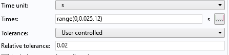

I believe the problem comes from the conflicting of the "Step 1: Time Dependent" and "Time Dependent Solver 1" nodes. If you set the time range as range(0,0.025,12) in the Step 1 node, but set the Time Dependent Solver option "Defined by study step" to be user defined, then the default time steps would be range(0,0.1,1). Check the Time Dependent Solver node just to make sure.

Posted: 6 years ago 30 apr 2020, 14:06 GMT-4
Hi Alex,
thanks for replying. Yes I guess you are somehow right. I had that option as "Defined by study step" and not "User defined" but it's strange since in light gray the option has 0.1 s, it shouldn't be working that way.
