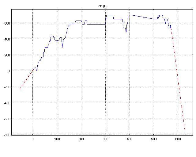

if you have the points as a list in a file use rather the Interpolation function, you can load the file directly, the in the BC you call the function i.e. int1(t[1/s]) (if you have not filled in the Units in your definition, and if the time base is seconds, or just int1(t) if you have defined the units in the function.
If your function is a space dependent and not time dependent, you load it in the same way (3-4 columns) then you call it with a int1(x,y) or int1(X,Y) or, if you chewck the "use space coordinates you can call it simply int1 without any arguments (add a third argument Z if you are in 3D)
These functions can be defined in the Definition node to be globally avaialbel, or in the material sub node if its purely a material interpolation function
indeed your line looks rahter spiky, why not try some smoothing, but with the cubic spline it might even oscillate more, in which case some smoothing could be applied, probably outside COMSOL on the raw data.

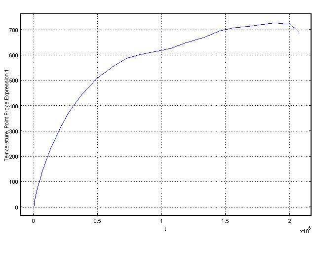

Even though we thought that the lines looked spiky the solution converged . But the temperatures profile in transience did nt follow my exact path .. it rather followed kind of a smooth curve.. but experimentally i have a curve which is spiky as well based on power input .
Input : Spiky/ piecewise linear power input
Output : (model) Smooth temperature transition
Output: (Experimental) Spiky/ piecewise temperature transition
now to match the experiment data .. should i consider using an approximation called efficiency of heaters varies with temperate . ?
i have attached the required data and graphs .. ! please suggest ! <------------ (This statement is for all !!)
that depends on where and how you measure your temperature, there is the heat diffusivity to consider, even if you hange the power abruptly, the heat needs time to travel through any material, this has an impotant "damping " effect and will smoothen a T value, particularly if its obtained by integrationg over a given boundary or domain

perhaps your experimental sensor is seeing more external temperature than the internal ones you try to estimate, or the material properties are not the same, there can be many things ;)
worth a second check with some simple hand calculations to see if your model seems OK
