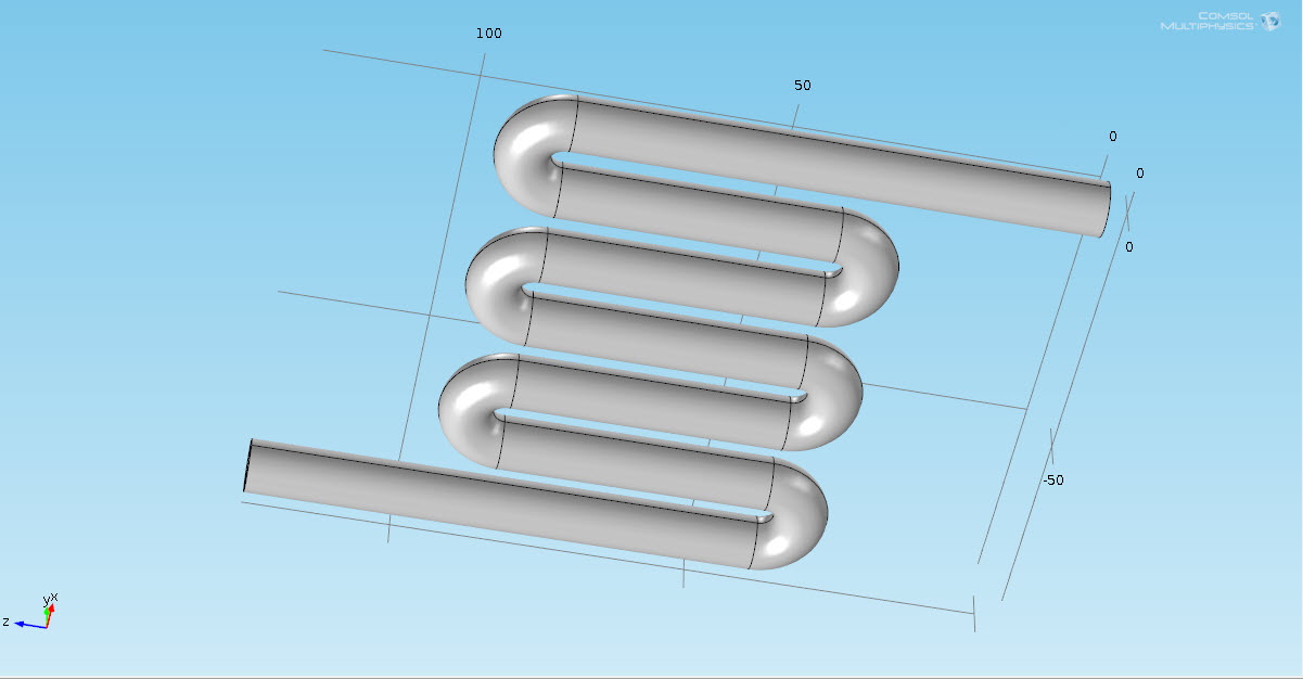

I am attaching the model of the pipe I tried again and again to run the simulation but I am unable to do so. Any help would be appreciated

thermal flow interactions are very delicate, and doing that in 3D for large systems can become extremely RAM and processing time dependent. Have you asked yourself if you can simplify somewhat, conside r i.e. only a "U" with a half length and or separate mass transport and conducction (that depends on flow elocity and fluid + wall material properties. Just as the mesh can sometimes be of "poor" quality but still plenty to give correct results, hence lowering the mesh density (possible in laminar flow, hardly for turbilent flows
I cant open your file as it uses a module I do not have, anyhow my only comment is start simple, identify what is going on and then see what can be separated and /or added up linearly

HI Ivar,
Thank you for the reply I really appreciate it. Fortunately I do have HPC with me so the processing and it's application is no problem for me. I have thought of running a single but the application is very critical hence I have use the full pipe simulation . I am stuck at wall boundaries conditions since I imported the geometry inside the Comsol. I selected the solid. But the edges are giving me a large trouble. I don't know how to proceed .

you know that in V4.2 there is a new geoemtry "cap" functionality to close a tube or any hollow geoemtry to make the closed fluid domain, when one import only the solid, is it that that is your issue ?
