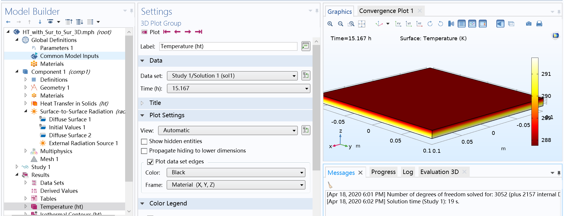

Hello! Tell me please different between boundary conditions: heat flux and external radiation source. I have two COMSOL project with thermal analysis: 1) Heat Transfer in Solids; 2) Heat Transfer With Surface-to-Surface Radiation. In both cases, the geometry (solid cube) and mesh are the same. In the first case my model has boundary conditions as heat flux on one side: 1000 W/m^2. In the second case my model (solid cube too) has boundary conditions on one side as external radiation source - infinite distance - posotion Y (-1) - Source Heat Flux: 1000 W/m^2 too. In the both analysis a Surface Emessivity is 0.6 on all outer sides of cube. Study: Stationary. As a result, the calculation results: temperatures, are differ from each other. Why?!!! I thought I would get the same results. What is the reason for this difference? Thank tou

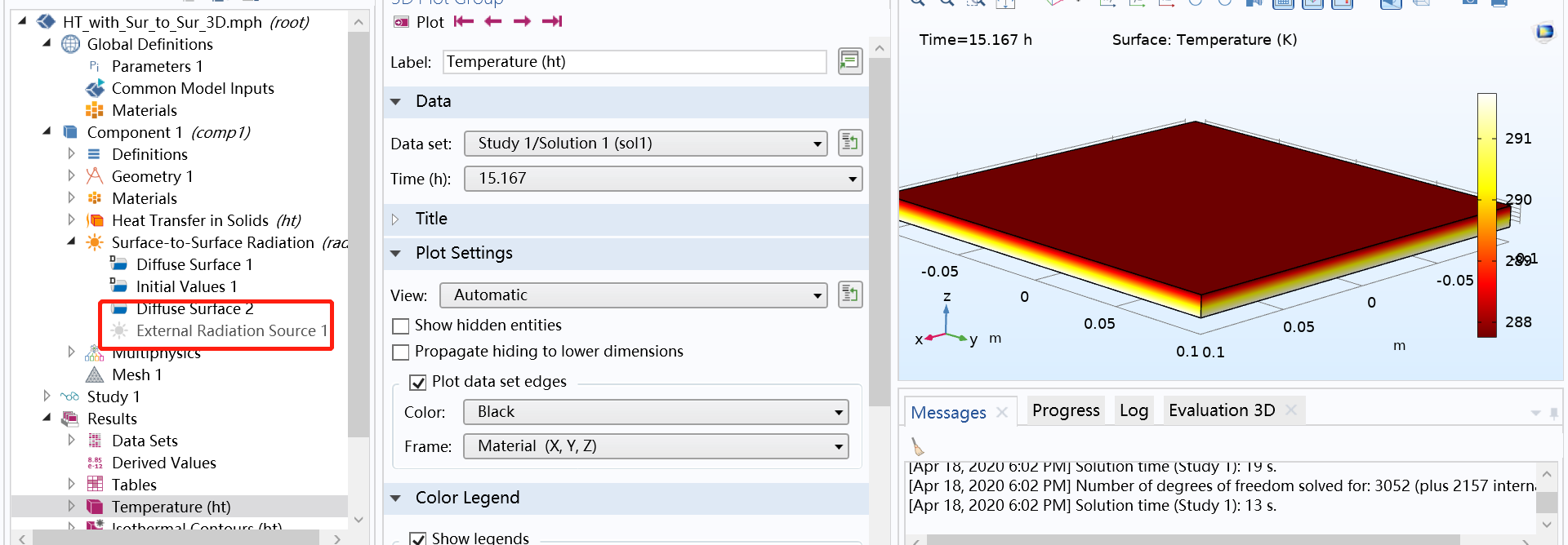

There might be difference in the material in both cases. Did you set the boundaries differently, such as thermal insulation / emissivity? You can check if all other conditions are exaclty the same.

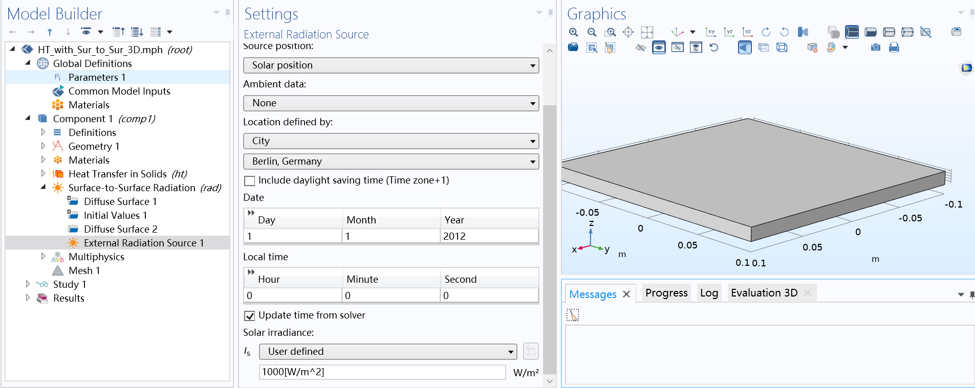

I am confused that when I add External Radiation Source it does not seem to work. When I disable that External Radiation Source the result does not change. Is there anything that I have missed?
Hi, There might be difference in the material in both cases. Did you set the boundaries differently, such as thermal insulation / emissivity? You can check if all other conditions are exaclty the same. I am confused that when I add External Radiation Source it does not seem to work. When I disable that External Radiation Source the result does not change. Is there anything that I have missed?
