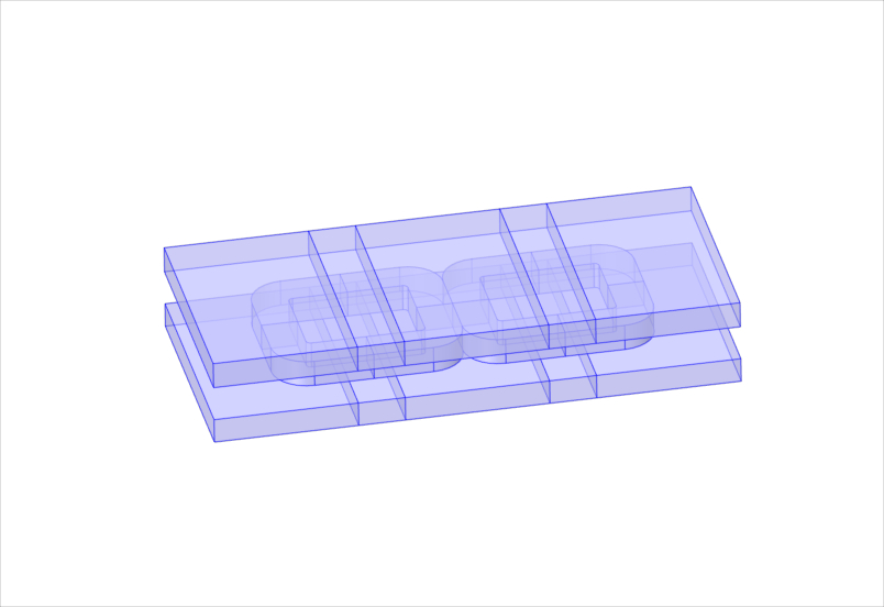

I'm using multiturn_coil_assymetric_conductor from the application library as a template for my project. The attached picture shows my geometry. There are two homogenized multi turn coils surrounded by metal parts. In reality this is one coil since they should be connected in series. How do I simulate this in comsol? I'm trying to calculate the inductance.
Do I need a more advanced non-closed coil geometry?
Edit: If I model them as two coils I get one negative inductance and one positive. Is the series inductance the addition of both? Or maybe the addition of the absolute values of both?
