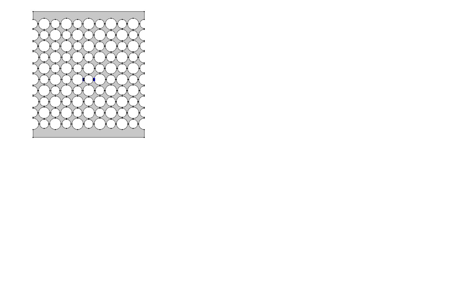

I am modeling a structure from silicone which has multiple holes in it as can be seen in the image. My question is, how do I model a spring with a predeformation between two sides of one hole. So I mean a spring modeled between the horizontal points of the hole which are blue in the image.

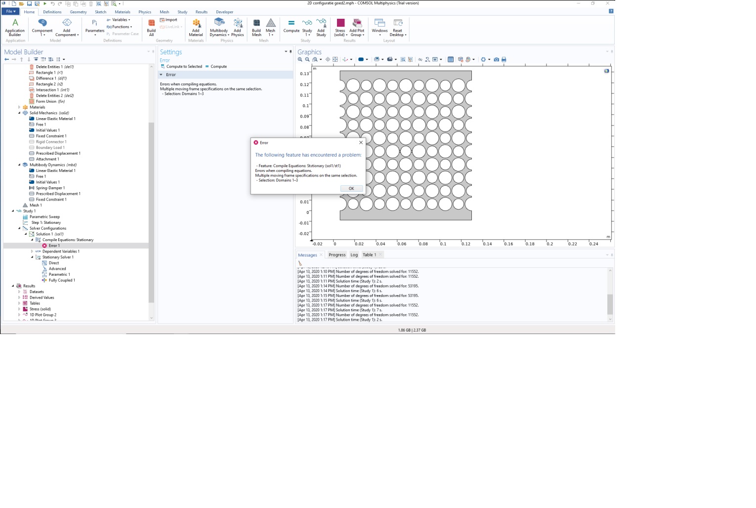

Thank you very much for your quick response. My model is indeed in solid mechanics interface and I want to model the spring damper in that interface. Like you said in your first solution you said that you can use the Spring-damper node from the Multibody dynamics in the solid mechanics interface by using an attachment. However when I do that I have a Solid Mechanics and a Multibody dynamics but I cant run both (multiple moving frame specifications). How do I use the attachment made in Solid Mechanics without running both physics (solid mechanics and multibody dynamics). (Btw I am also running it enabling geometric non-linearity).

There could be many ways to resolve multiple moving frame issue however the change suitable in this case is to remove any domains selected in the Multibody Dynamics. The global nodes like spring-damper, joints etc. can be (should be) used in the Multibody Dynamics without having any selection in the physics in the case when attachments are defined in some other physics. Hope it helps.
