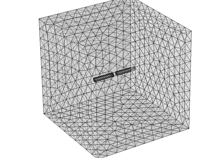

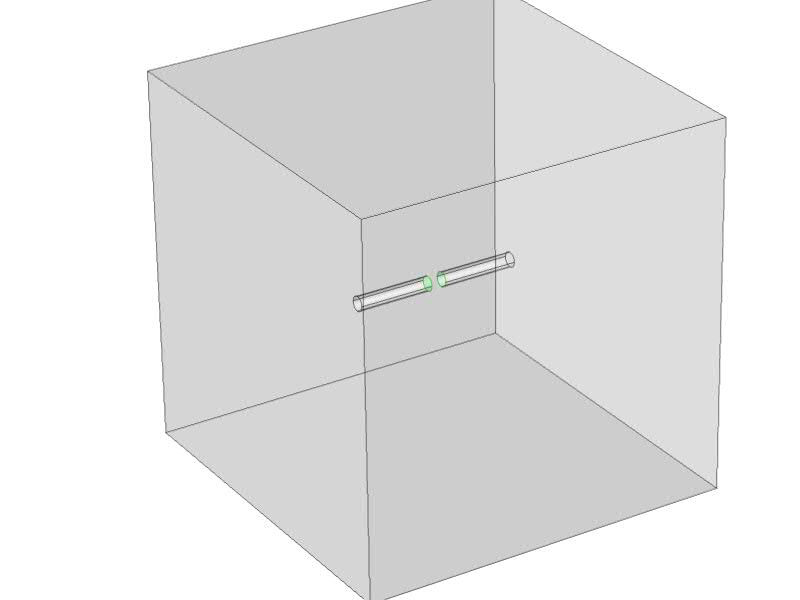

I'm trying to simulate a dipole with a voltage source in the middle of them. For that, I'm using a lumped port that is found in the middle of the dipoles, and it have the voltage that I want. But i'm having a very small input impedance. An I doing something wrong?
I found to a model tutorial simulate that use the lumped port, that is the "rf coil", and it's found in the rf module paste.
In the attachment is the geometry and where the lumped port is found, and my simulation too.

Gustavo,
there are a couple of errors in your model.
- The lumped port must connect the branches of the dipole. You can model it as a rectangle on a workplane on the xy-axis.
- It must be a uniform port, not coaxial, because the dipole is symmetric.
- The dipole branches' boundaries must be set to perfect electrical conductor or an impedance boundary condition. This is a COMSOL restriction. Lumped ports don't work if they are connected to explicit materials.
I would also recommend to use a PML. It will reduce inaccuracies from reflections.
And everybody recommends upgrading to the latest version. 4.0 is said to be buggy.
Cheers
Edgar
