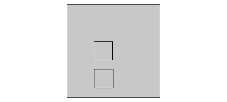

                                                    Thankyou sir Lars, i will check these modals, at the time i want to knoow how to give gravitational force (weight) to levitating magnet, should i use its equation in variables or i have to use another study ??
need you kind suggestion

                                                    You will have to model the movement of your device somehow, in the "Electrodynamic Levitation Device" model that I mentioned this is done by a moving mesh interface and two global equations, one for the position and one for the velocity in y-direction of the moving piece. If you look at the equation for the velocity, you will find this expression:
  d(v,t)+(F_g-mf.Forcez_0)/M_disc
This expression is implicitly zero, so you can understand it as "the acceleration is equal to the sum of the forces F_g (the gravitational force) and mf.Forcez_0 (the electromagnetic force) divided by the objects mass". If you are simulating a stationary problem, you do not need an equation for the velocity, but just for the position, where you can specify that the sum of all forces should be zero.
