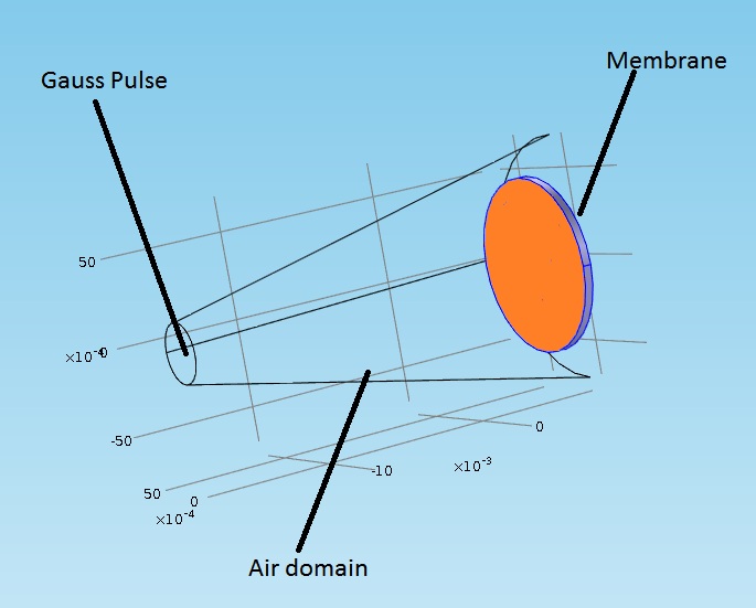

I would very much like to ask a few relatively simple questions regarding transient acoustic models with some regarding transient solid interaction.
In essence my models are looking at how a membrane found in animal ear's behaves to incoming sound pressure, I am only looking to model the membrane not the ear itself. As you can imagine the membranes are very thin (around 1um in thickness and 2000um in diameter). I am doing the models in 3D and am looking at how the membrane deforms in the presence of a sound pressure wave.
I have adapted the Gauss Pulse model to a 3D one. I am modelling the source of the sound as a point Gauss Pulse.
My questions?
1)
Is there a better way to model an incoming sound field? The problem is that I need to place the Gauss Pulse relatively far from the membrane such that the incoming wave has a relatively flat wave front as it comes into contact with the membrane. This however creates relatively large models.
Is there perhaps a plate that I could use as the source of the pulse?
2)
Does anyone know of any other models which I could look at? There are not that many models in Comsol that look at Acoustic-Solid interaction.
3)
Any thoughts or suggestions on how to make the model more efficient.
I have included an image of the model so make things a little clearer.

I can give you suggestions on the different ways to give your source input.
Don't really know how efficient they will be.
1) Using a flow point source you can give your own pulse input .
For eg. S=4*sin(2*pi*100000[Hz]*t)*(t<=0.000001)
In the equation dS/dt is used.Here you have a pulse of frequency 1MHz and time period=1u sec.
2) Using the pressure boundary condition. Since its in 3D you can select a surface as the boundary
and give your pressure pulse as above in the p0 field.
3) Having a background field. Use the cylindrical, plane or spherical wave boundary condition and using the incident pressure field mention the direction of incidence by specifying your propagation constants.
I'm not sure of how effective they are comparatively, just started working on acoustics some time back.
There are couple of models that could help in understanding, a 4.1 version is the hollow cylinder .
I'm not exactly sure if i've helped you.
Regards
Glenston
