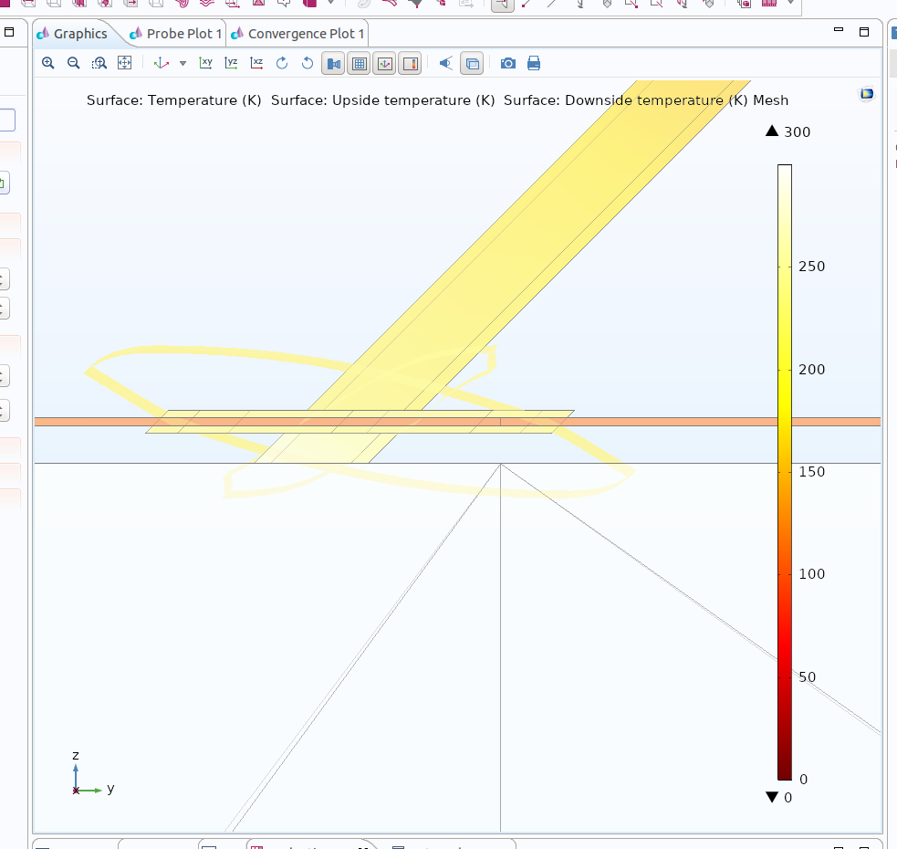

Result from Study outside of defined geometry
Hello!
Currently I am simulating heat transfer with Heat Transfer in Solids and Surface-to-Surface Radiation. Looking at the result for the temperature distribution in my geometry I can see that there are results and temperature distributions outside of my defined geometry, which seems odd. (See attached picture: squiggly yellow bands encircling a layer, positioned near the middle of the picture.)
It does not seem to be coming from the meshing. With a mesh plot overlayed, I can see that the "bands" are not meshed.
Can somebody explain how this happens and what it means? Comsol can even evaluate the temperature at these points.
Best regards, Yao
1 Reply Last Post 30 apr 2020, 14:39 CEST
Hello Yao Zhou
Posted: 5 years ago 30 apr 2020, 14:39 CEST
I found the answer to this question.
These are deformation plots, which are generated automatically. They can be found the Temperatur Plot Group.
I found the answer to this question. These are deformation plots, which are generated automatically. They can be found the Temperatur Plot Group.
