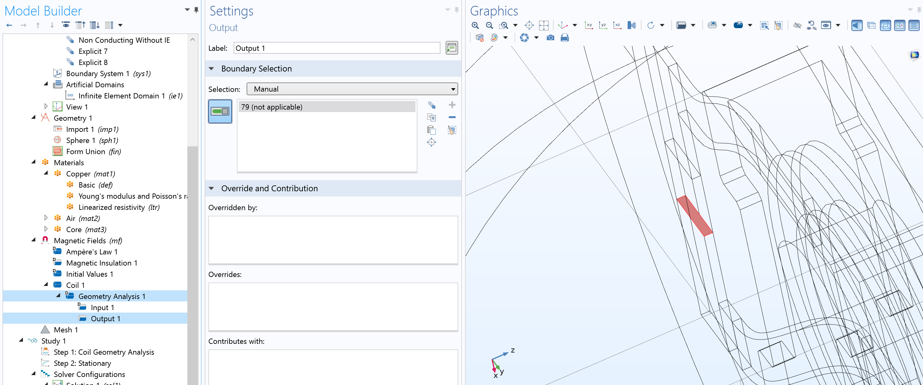

"Modeling of a 3D Inductor" - Cannot define output
I'm currently following the "Modeling of a 3D Inductor" tutorial and have run into a strange issue. I cannot define an output for my magnetic field study as the guide directs me to. When I try to select a boundary, all options have (not applicable) written next to them. I'd like to select boundary 79 as my output (see screenshot attachment).
I've followed the instructions to a T thus far so I'm not sure what might be causing this issue or how I can resolve it.

the output port should be at the boundary of the air box,and the you could set the surface 79 as the output. my mail is 18709281522@163.com, welcome.

Hi Michael Spinazze, If you share the model, I can go through it if you have not solved it yet. Regards, Okan
