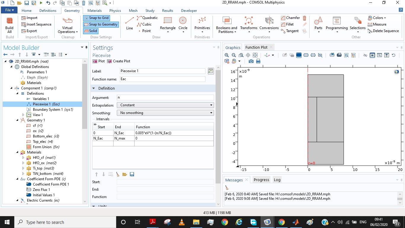

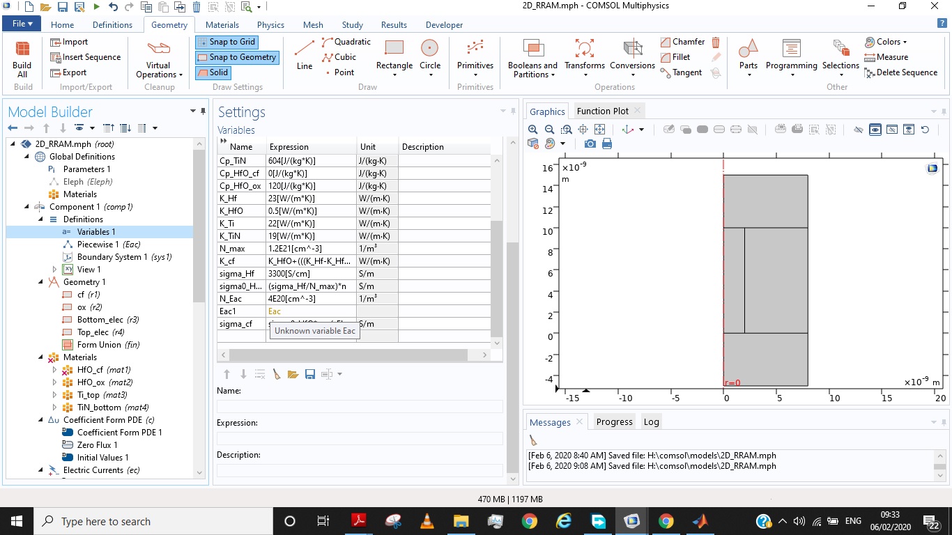

I am using comsol 5.4. When I define a piecewise function and use it to write expression it is giving an "unknown variable error". (see images). What is going wrong here??(units are all correct)

Hi Ayush, you defined a function, thus should call it with its argument: Eac(n)

The argument in the function call doesn't need to be 'n', which is just a generic variable in the function definition. It can be any valid expression. But there must be an argument.
