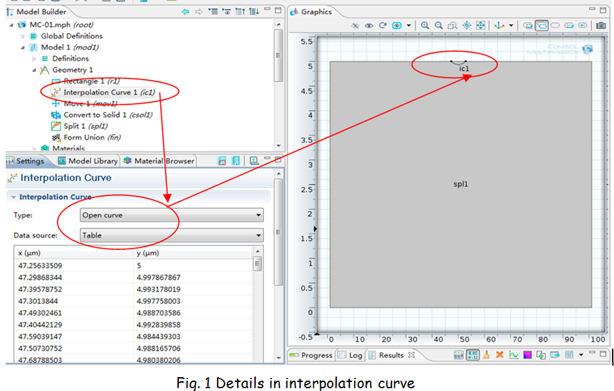

I have built a geometry using “rectangle” and a “interpolation curve” (which is new function in Geometry node of the new V 4.2a). The original source in the “interpolation curve” is a file (a series of x-y positions obtained from COMSOL using “export”), and then I import all the data into the software into a “Table”. The plotted interpolation curve with the name of “ic1” is illustrated in Fig.1.

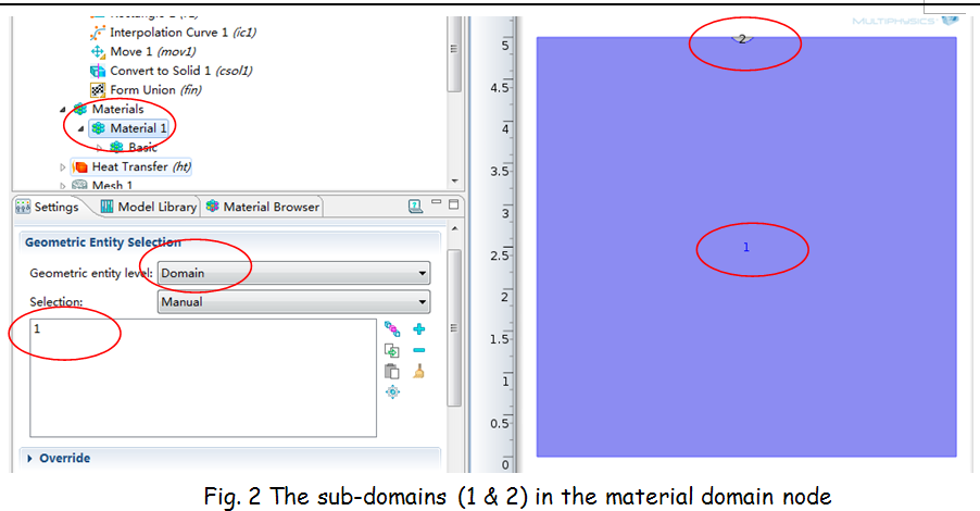

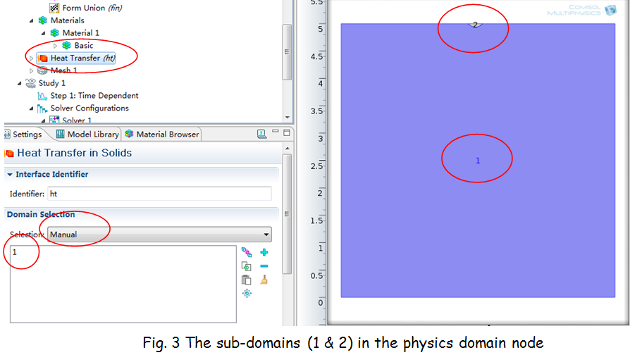

The software COMSOL can automatically recognize the “interpolation curve”. As the Fig. 2 (in the material node) and Fig. 3 (in the physics node) shown. The original domain is divided into two domains at a first glance.

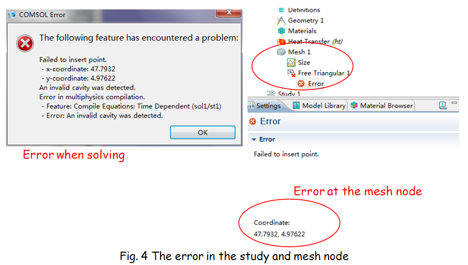

While when I solve it, the following error occurs (shown in Fig. 4):
Failed to insert point.
-x-coordinate: 47.7932
-y-coordinate: 4.97622
An invalid cavity was detected.
Error in multiphysics compilation.
-Feature: Compile Equations: Time Dependent(sol1/st1)
-Error: An invalid cavity was detected.
Firstly, I didn’t know its meaning. I searched the error in the forum with the help of finding the reason and solution. Then I look at the mesh node, the above-mentioned error are also shown in the mesh node (just shown in Fig. 4).
