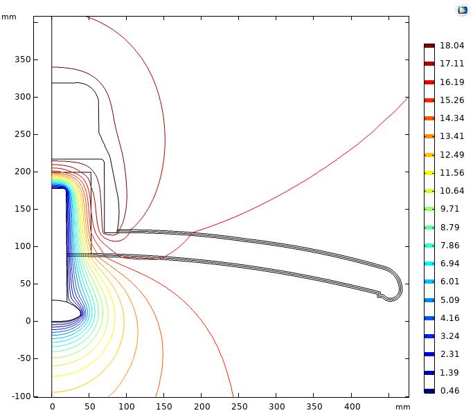

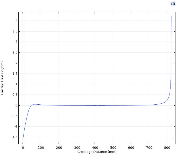

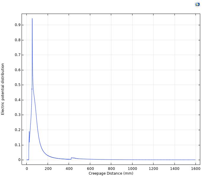

I am trying to simulate the electric field and electric potential for clean glass insulator inergized with 18.5 kV AC 50 Hz
Here is the result I got. can anyone please validate these result ? are they realistic ?
