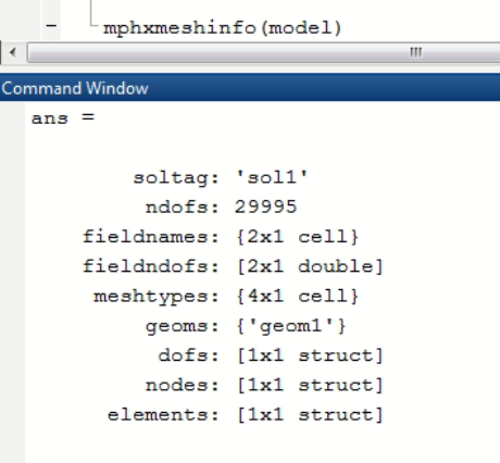

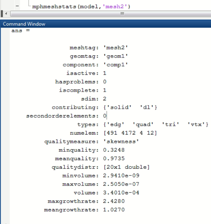

                                                    Hello Lars,
I need to do some calculations by using the Darcy's Velocity (dl.U) in element level and use this information for other calculations. I tried mphmeshstats and mphxmeshinfo functions and the outputs are given as screenshot below. It seems like it doesn't give me what I want. Do you have any other suggestions? Or should I do additional things with those functions?
Thank you,
                            Hello Lars,
Thank you,

                                                    mphmeshstats has an extra output. See the LiveLink for Matlab User's Guide in the section titled "Extract And Create Mesh Information".
The output of xmeshinfo is a struct with a lot of sublevels which are not for the faint of heart.
