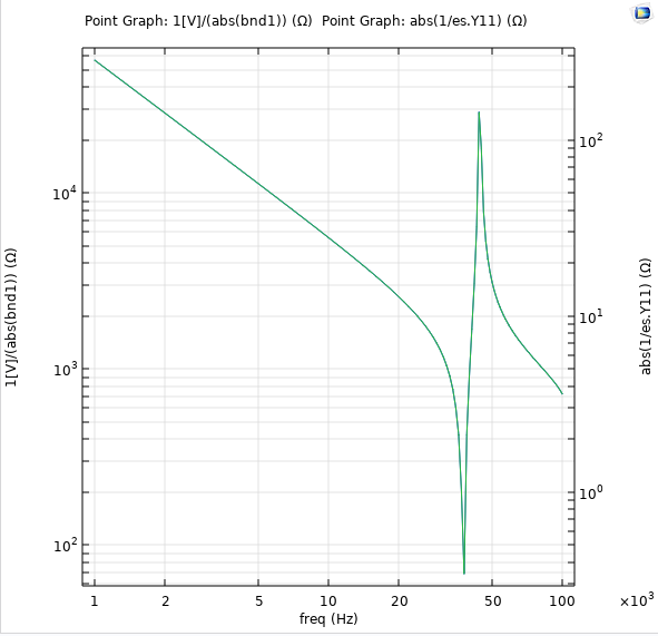

Thank you very much for the message. Please check the attachment.
I checked with 2D model. I used both 1[V]/(abs(bnd1)) from the boundary probe (Current) and abs(1/es.Y11) as global evaluation. The one with boundary probe has Impedance of 10^4 range and for the global evaulation it is 10^2 range.
Both the impedance curve falls on the same line, but the scale is different.
Thank you very much for the message. Please check the attachment. I checked with 2D model. I used both 1[V]/(abs(bnd1)) from the boundary probe (Current) and abs(1/es.Y11) as global evaluation. The one with boundary probe has Impedance of 10^4 range and for the global evaulation it is 10^2 range. Both the impedance curve falls on the same line, but the scale is different.

Well either or both are wrong. Since I don't know what or where you are probing I will put my money on es.Y11.
Since you know the permittivity of the piezo (at least approximately) a good check is verifying that the capacitance away from resonance is correct.
Well either or both are wrong. Since I don't know what or where you are probing I will put my money on es.Y11. Since you know the permittivity of the piezo (at least approximately) a good check is verifying that the capacitance away from resonance is correct.
