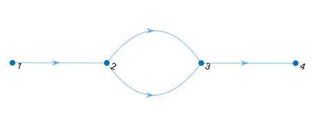

I am new to COMSOL. I am looking for a tool that can simulate flow through branched pipe.
I'd like to know if it is possible to simulate 1D solute transport in a pipe section that diverges into 2 sections and converges again .

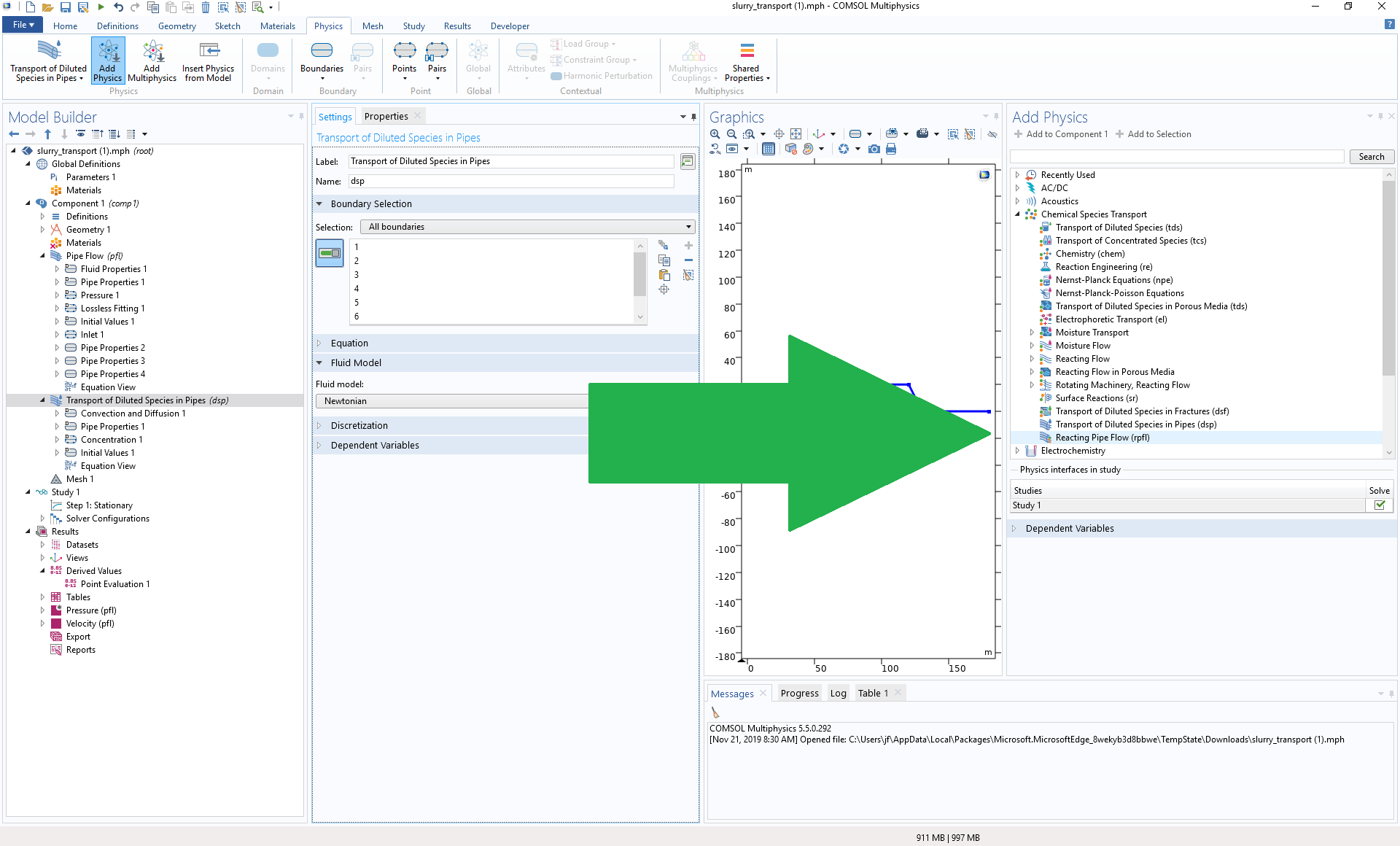

The Pipe Flow Module does also offer an interface for modeling advection diffusion (and even chemical reactions if you need that), see attached screenshot. This link gives an overview of the Pipe Flow Module, and you can use File > Help > Documentation within the software to reach its detailed documentation, assuming your license includes that module. I don't know of a ready-made tutorial that illustrates that specific interface on the type of geometry you are working with, but all the Pipe Flow Module's interfaces follow the same general philosophy so the tutorials you'll find in the Application Libraries (also found under the File menu) for the Pipe Flow Module should still be helpful to you.
You can check whether your license includes the Pipe Flow Module by going to File > Used and Licensed Products.

Hello, The Pipe Flow Module does also offer an interface for modeling advection diffusion (and even chemical reactions if you need that), see attached screenshot. [This link](https://www.comsol.com/pipe-flow-module) gives an overview of the Pipe Flow Module, and you can use File > Help > Documentation within the software to reach its detailed documentation, assuming your license includes that module. I don't know of a ready-made tutorial that illustrates that specific interface on the type of geometry you are working with, but all the Pipe Flow Module's interfaces follow the same general philosophy so the tutorials you'll find in the Application Libraries (also found under the File menu) for the Pipe Flow Module should still be helpful to you. You can check whether your license includes the Pipe Flow Module by going to File > Used and Licensed Products. Best regards, Jeff
