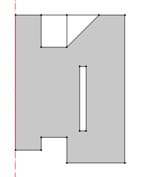

How to do add a constant magnetic field to a physical domain
I am a newcomer,and I want to ask how to add an upward magnetic field in the figure below ,Thank you
1 Reply Last Post 17 nov 2019, 11:47 GMT-5
Posted: 6 years ago 17 nov 2019, 11:47 GMT-5
Updated: 6 years ago 17 nov 2019, 11:49 GMT-5
you can apply a magnetic potential to the boundaries of the model. In case of mfnc this would be the scalar potential Vm = 1[A/m]z for a field of 1 A/m in z-direction. In case of mf it is Ar = 0, Aphi = 0.5[T]r and Az = 0 for a field of 1 T in z-direction.
Of course any magnetization inside the model will distort this field.
Cheers Edgar
