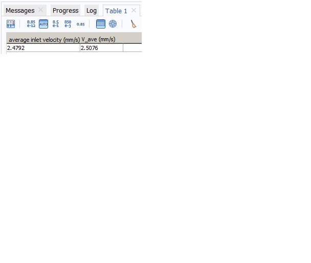

                                                    Jacob,
- Two legends because you have Slice and Multislice for one Velocity plot group. To get rid of one, just clear "Color legend" box for one plot.
- Default "Wall" boundary condition node is applicable to the exterior fluid bounaries only and not applicable to the structural boundaries. So, there is nothing wrong that structural boundaries are laabeled as "(not applicable)".
- You maximum velocity is 3.76 mm/s which is in agreement with the specified volumetric flow rate of Q=80[gal/min] =0.00505[m^3/s]. To verify this , you can calculate average inlet velocity analytically (see Parameters node in the attached mph file) and compare it to average velocity obtained from your Comsol model V_ave=aveop1(spf.U). Results are in agreement very well, as shown in the attached image.
Regards
Sergei

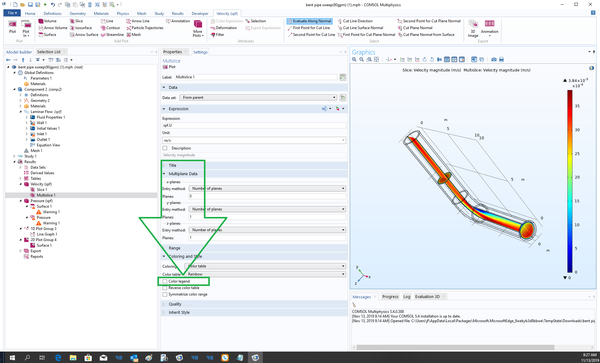

                                                    Hello Jacob,
Those surfaces are not applicable because they do not touch the region where the PDEs are being solved. In other words, you can't apply a boundary condition to a surface that's not a boundary of the computational domain.
Regarding the two color legends: one comes from each of the two plots inside your plot group. The GUI lets you turn them off individually if you'd like, see screenshot attached.
Jeff!
