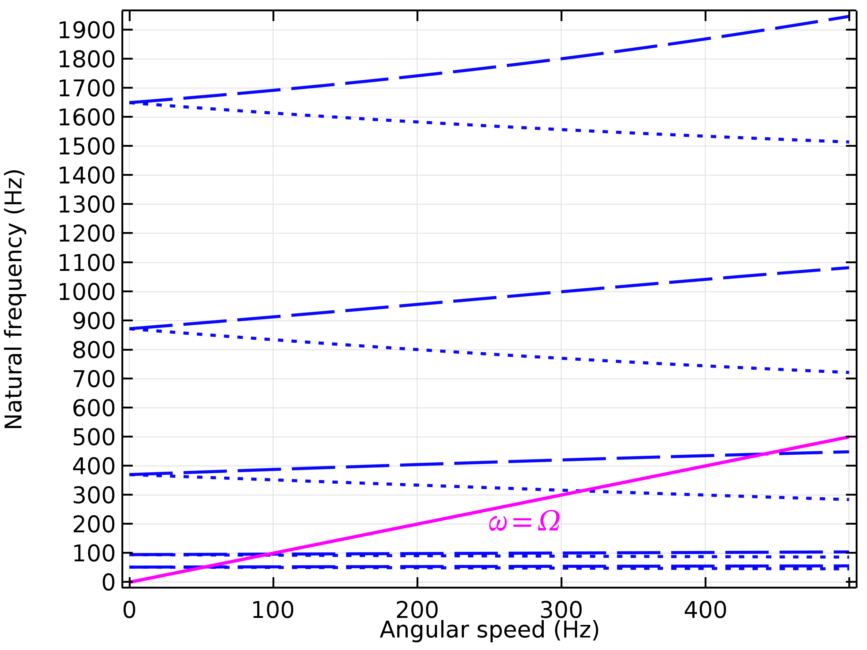

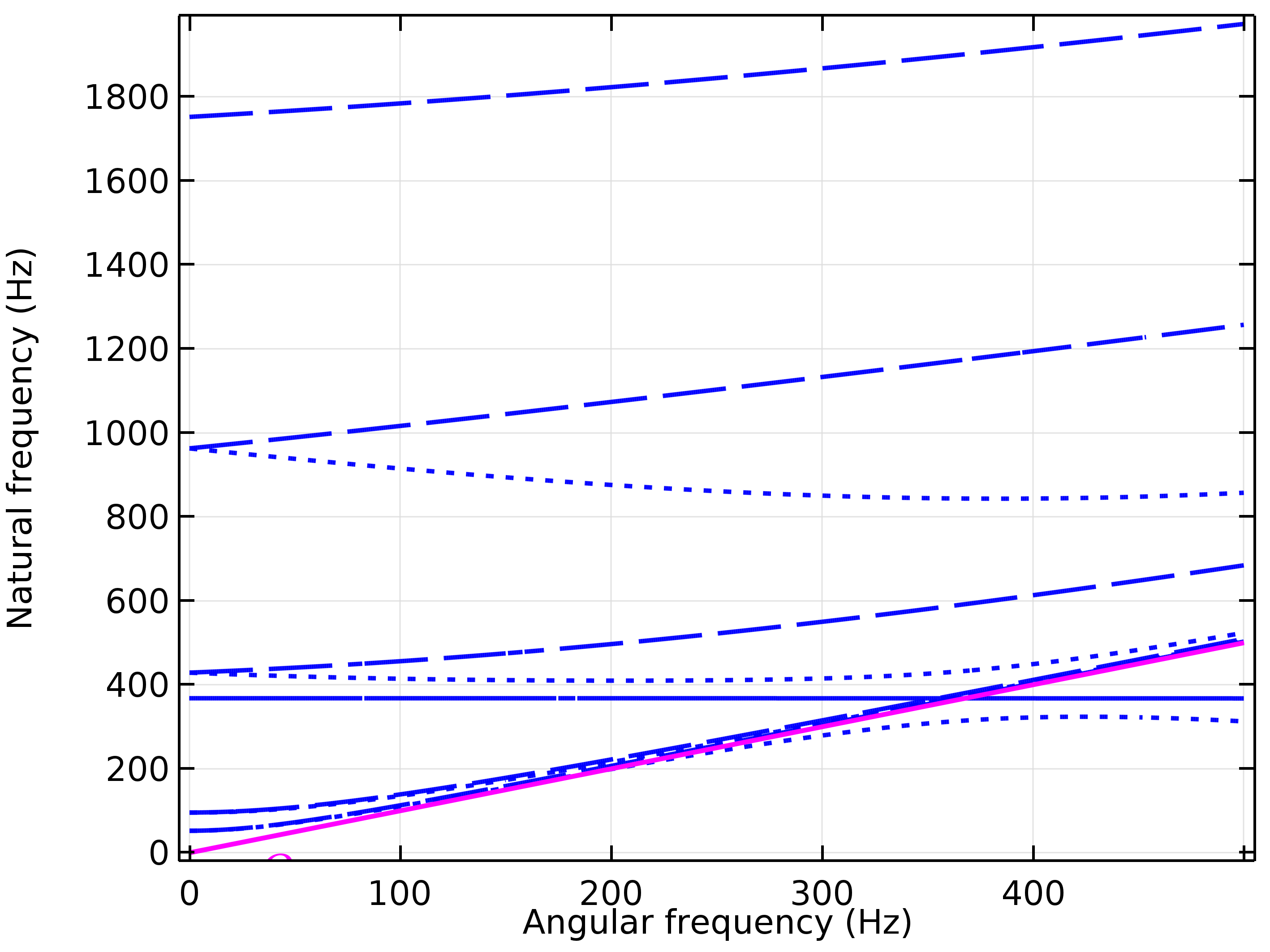

Clearly, not only the value of the eginfrequency has changed significantly but also the order in which the modal appears is confusing calculated by solid elements under high rotational speed , which is unreasonable according to rotor dynamic theory. But this problem will not appear when using beam elements to model the rotor. And the campbell plot of solid rotor and beam rotor are in the attachment.
