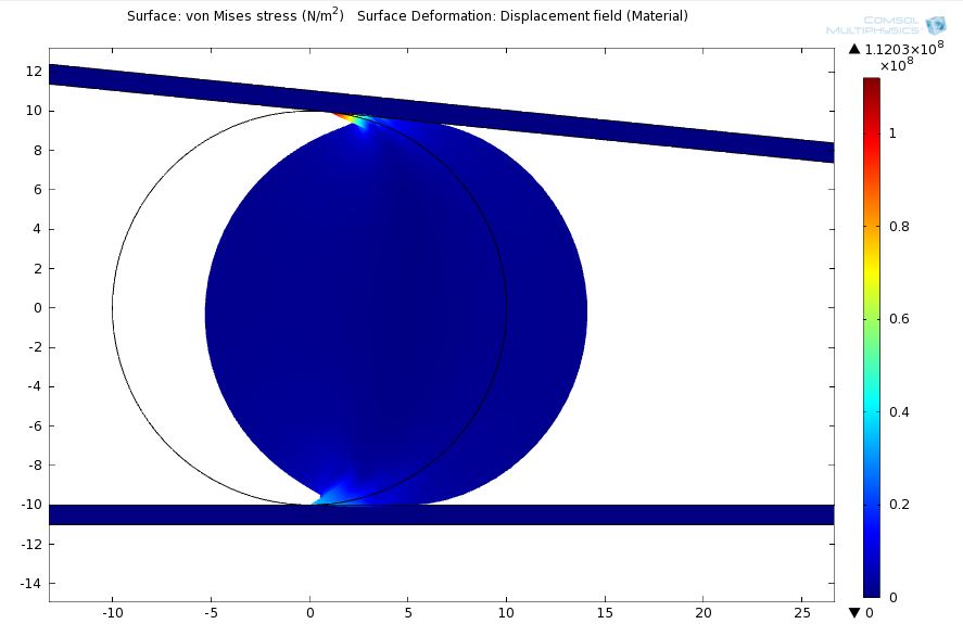

I am trying to model a sphere pushing into a tapered cylinder. To do so, I have created a 2D model with a load. Since the two surfaces will be tangent to the sphere surface, I use contact pair to handle the point contact issue. The sphere will deform under this load and move forward a little bit. I want to know the distance under different load.
However, the plot of the distance indicates that something is wrong. The disntance of the contat point is zero, which is shown in the attachment

The problem seems to be that the sphere is attached to the plates at the contact points. Make sure you keep the parts separate by using the COMSOL Assembly instead of Union feature.

Can you make it more specifically? I didn't do any union operation on this model.

Check the last node under Geometry. Change “Finalization method” to “Form an assembly” instead of the default “Form a union”.
