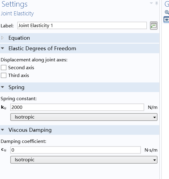

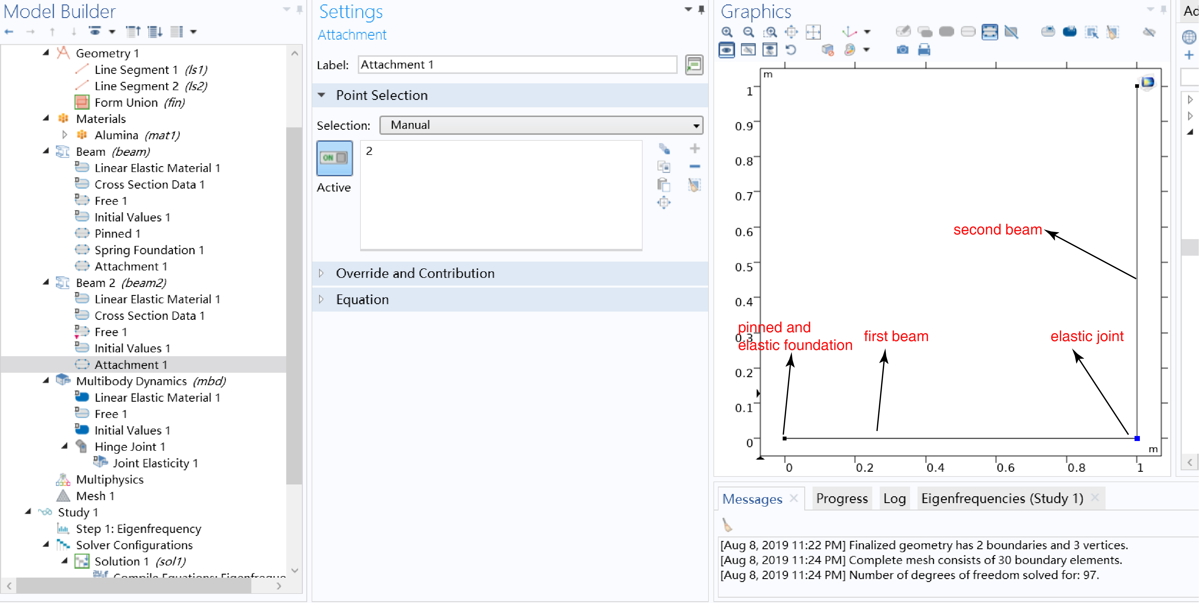

Dear Henrik Sönnerlind,
Thanks for providing me the solution.
I tried your method. I use two lines to represent the two beams. Then the first beam is hinged to the ground by using the pinned and spring foundation. The first attachment is at the right end of the first beam while the second attachment is at the left end of the second beam. The two beams are connected via the MBD hinge joint. But when I solve the problem, the error message shows that comp1.beam.att1.phi variable is not defined. Can you tell me the possible reason and how to solve it?
Undefined variable.
  - Variable: comp1.beam.att1.phi
  - Global scope
Failed to evaluate Jacobian of expression.
  - Expression: comp1.mbd.hgj1.uc_src-comp1.mbd.hgj1.uc_dest
Thanks.
