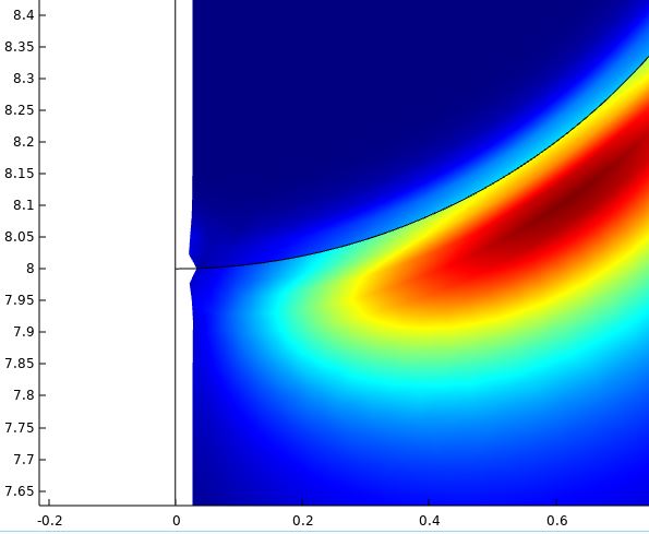

Hi all, I'm simulating ferrohydrodynamics and I'm trying to impose a Volume Force in the Laminar Flow physics. This volume force has a part like this:
((1/r)(d(r(d(A,r))^2,r))+d(d(A,r)d(A,z),z))mu0_const
where "A" is the magnetic scalar potential. When I plot this term, the closest layer to the axis has not been taken into account actually (take a look at the attached image please, the black vertical line is the axis.) How can I prevent this problem? I have instabilities on the axis because of this issue. Thanks

Milad,
the 1/r term goes to infinity at the axis (r=0). You need to prevent that some way, maybe by adding a constant>0 in the denominator: 1/(r + const). And you need to be aware that the symmetry does not allow any nonzero radial component at the axis.

Milad, the 1/r term goes to infinity at the axis (r=0). You need to prevent that some way, maybe by adding a constant>0 in the denominator: 1/(r + const). And you need to be aware that the symmetry does not allow any nonzero radial component at the axis. Cheers Edgar

Edgar Thanks for your response. This term is a divergence from a field, that's why it makes 1/r. Consider the continuity equation for instance: how this equation is written in 2D-axisymmetric? Does the COMSOL itself prevent 1/0 by adding a constant to its denominator too? Thanks, Milad

Comsol isn't modifiying your expression. You need to take care of cases like this by yourself.
