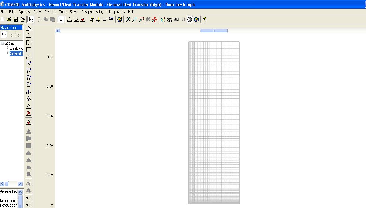

Hello;
I've been recently used Comsol Multhyphysics 3.4. I encounter more or less the same problem. I want to seperate my rectangular 2D axial symmettric geometry into meshes which are intenser at each individual boundaries. When I use mapped mesh parameters I specify element ratio, number of elements and distrubition (linear or exponential). But I can only get intenser meshes at 2 out of 4 boundaries.(see attached file) could you please help me to achieve this.
Thanks in advance
