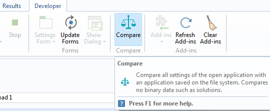

Are you aware that you can compare the mph files directly? See the attached screenshot.
If you want a shortcut for saving as java, you can add a very short model method for that operation. It would only need a single instruction like
model.save("C:\tmp\myfile.java", "java");

Hi Alexis, Are you aware that you can compare the mph files directly? See the attached screenshot. If you want a shortcut for saving as java, you can add a very short model method for that operation. It would only need a single instruction like model.save("C:\\tmp\\myfile.java", "java"); Regards, Henrik
