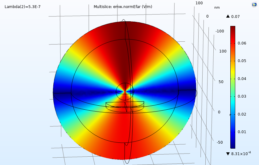

Thanks for your reply. I illuminate a nanosphere with a plane wave and I want to find the total power scattered in the far field. When I integrate ewfd.(normE^2)/(2Z0const) over the main sphere I get an extremely small value.

I'm interested in the total power scattered to the far field.
I made a typo error in the expression in my previous power.. I meant it is
ewfd.(normEfar^2)/(2Z0const)
At what distance should I make the surface integration?
The variable normEfar is calculated in comsol at 1[m] so I think it is constant with the distance..it only differs with the angle as shown in the attached figure.. so why my result differ when I integrate over closed surfaces with different radius?

                                                    Energy conservation ensures one can calculate the power in the near field. Or maybe you are interested in more than the final result?
