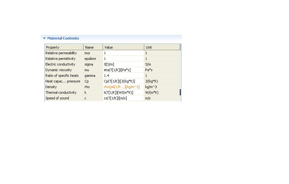

When I open the built properties of air defined, I find something like this (please the attached image)
If I define the density of oil as:
rho(pA[1/Pa],T[1/K])[kg/m^3]
which is the way it is defined for built in air density. It is visible that density of air is being changed with change in temperature and pressure but how is it considering the initial density of air?
And how can I define the initial density for the oil and what will be the final value of density after the simulation, can I see it?
Many thanks for feedback!

Posted: 1 decade ago 26 ott 2011, 09:08 CEST
Hi Muhammad,
this post should answer both of your posts...
On the picture you uploaded, you defined the property as being a function, not a constant. This is perfect so far, but you still need to define your function (that's why it's colored in orange...).
How to do this?
In the materials node of the model builder, choose the correct material and right click on the respective property group (Basic, Dielectric Losses,...). There you can add the function and define it as it best suits your problem (analytic, piecewise, interpolation).
Again have a look on the properties/functions of air to learn how to properly do it, the usage of the different function types should also be clear after a short look on the built in materials.
