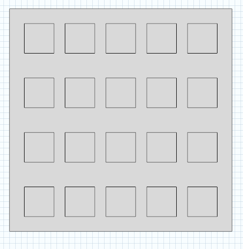

I am trying to do something very similar. i want to create n copies of a circle using the 'copy' command and then manipulate only some of the copied objects using the 'compose' command. I have created a 'selection' for the copied objects but cannot find a way to automatically choose all the copied objects in the 'formula' for the 'compose' operation.
Has anyone have a found a solution to this?

The trick is to use 'Selections of Resulting Entities' in the Array menu to 'Contribute to:' 'resulting selections'. You can then in the boolean menus select the cumulative selections you create from the Array sub menu. Cheers!
