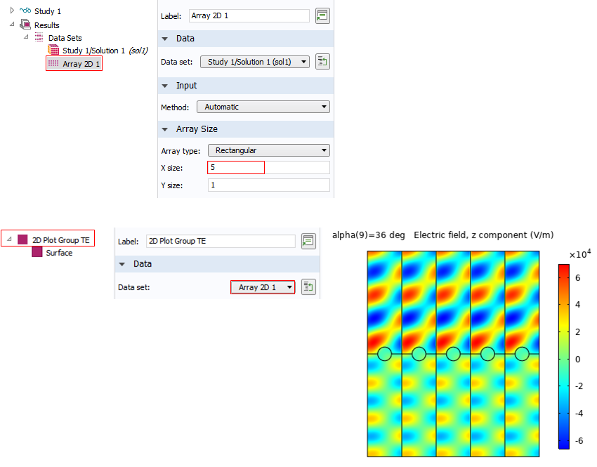

To plot many periodic cells, create Array data set and the reference to this set in a Plot Group, as shown in the attached image.

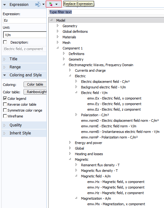

There a lot of predefined variables - you can use Equation View or Replace Expression option to see the list of predefined variables.

                                                    I did manage to create an Array data set and plot it, thank you.

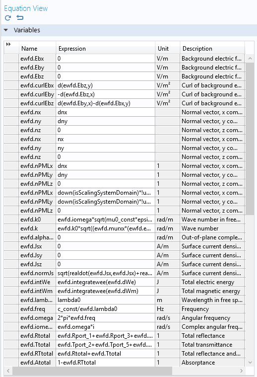

On the other hand, I did not find the "Replace Expression" feature. I enabled "Equation View" where it shows variables like "Surface current density, x component" (see figure eq_view.png) but don't know how to plot it as a function of x for example.
How can one see all functions COMSOL had by default and is there a tutorial about the syntax used by COMSOL to insert new functions?
