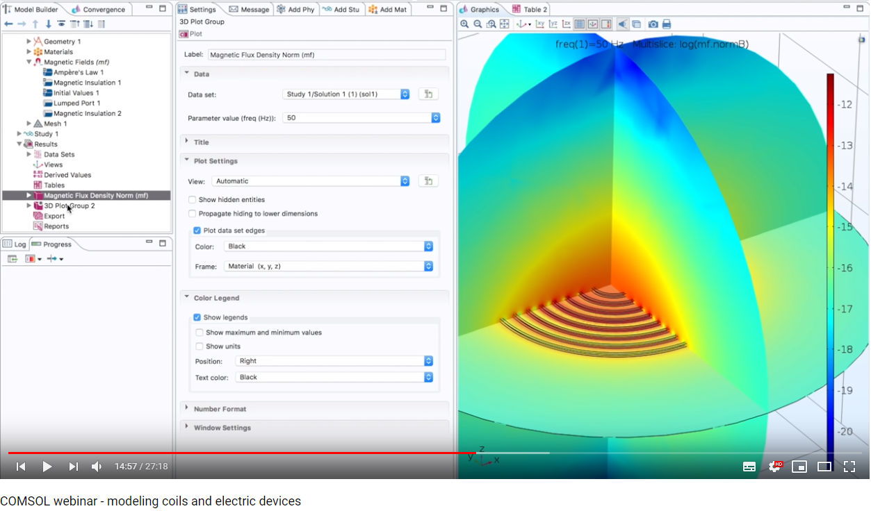

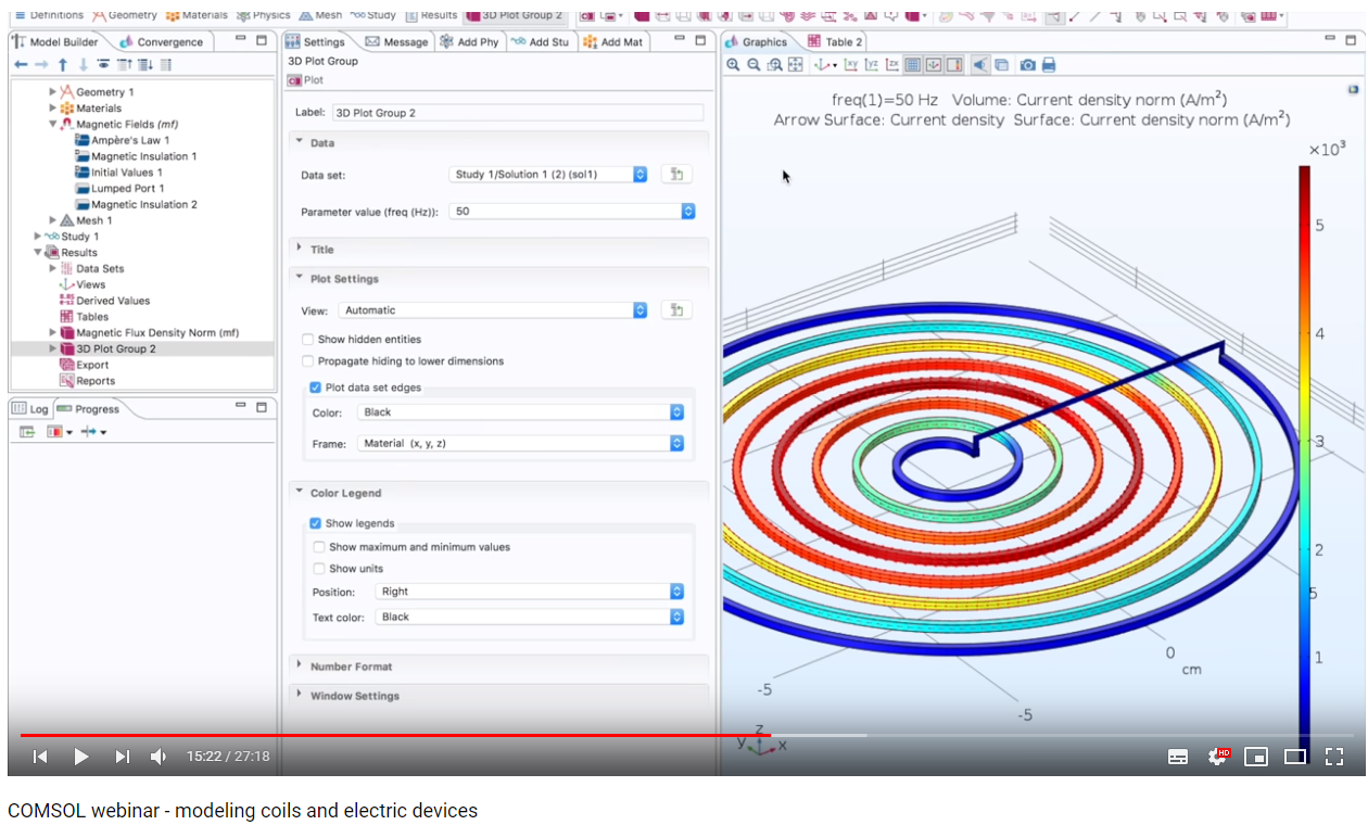

I have attached the file but the results do not seem correct, I feel as if the coil itself may not be defined properly and no current seems to be running through it. What is the best way to make the lumped port to work in order to excite the coil at a frequency of 90kHz? I have also attached 2 screenshots from a video seen online for the results I am hoping to achieve.
