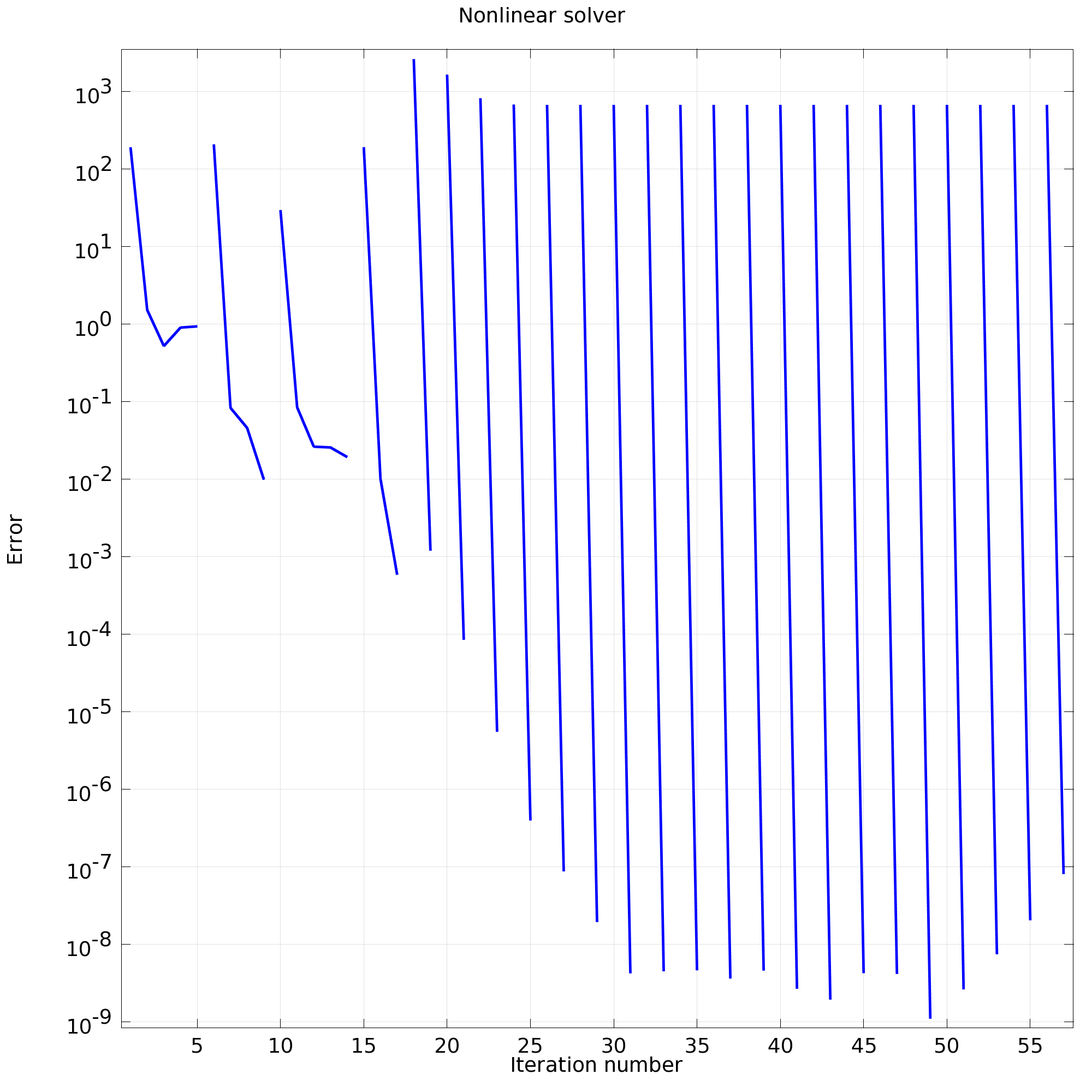

I did try to set the t as a parameter as you mentioned and then have it used as a built-in variable by the time -dependent solver but it gave me far too many problems so I simply cut the corner and divided the problem into two studies. When you open the solution of the time dependent one, if you defined everything correctly, you actually start from the steady state solution and you can see how it evolves over time.
If you manage to get the t-parameter work please let me know.
Regarding your convergence plot, it looks perfectly fine.
Cheers

Okay, so I somehow managed to get the t-junction model to run time dependent and not fail at the first time point. I've really no idea how I managed to do it. I was very surprised when the solution with no-change to the input boundary conditions worked. Maybe because I got rid of the concentration physics to see if that helped, maybe because I rebuilt the structure and regridded. I'm very unsure of how changing things in the model definition filters through the solver as it doesn't seem very consistent or intuitive to me. Anyway. I then put back in a step and tried running it again. This time it did something similar to Amir's after nearly 0.15s (which is just as the step completes) the time step size shot down to the 10e-13 range then after a further 10 minutes or so of slowly falling it got stuck oscillating between 6.5e-9 and 1.3e-9. I'm afraid I'm running this remotely so I can't wait for this to take weeks to solve so I stopped it at that point and I'm attaching the file saved at that point. Help would be gratefully received. Otherwise I will just have to give up I think.
Stewart
Okay, so I somehow managed to get the t-junction model to run time dependent and not fail at the first time point. I've really no idea how I managed to do it. I was very surprised when the solution with no-change to the input boundary conditions worked. Maybe because I got rid of the concentration physics to see if that helped, maybe because I rebuilt the structure and regridded. I'm very unsure of how changing things in the model definition filters through the solver as it doesn't seem very consistent or intuitive to me. Anyway. I then put back in a step and tried running it again. This time it did something similar to Amir's after nearly 0.15s (which is just as the step completes) the time step size shot down to the 10e-13 range then after a further 10 minutes or so of slowly falling it got stuck oscillating between 6.5e-9 and 1.3e-9. I'm afraid I'm running this remotely so I can't wait for this to take weeks to solve so I stopped it at that point and I'm attaching the file saved at that point. Help would be gratefully received. Otherwise I will just have to give up I think. Stewart
Posted: 1 decade ago 4 ott 2011, 07:54 CEST
you have initial conditions = 0 (study1) then you apply a non zero flow and ask COMSOL to find directly the good starting point, this is always delicate, you could use a short ramp to get the flow going, or add a reasonable initial flow velocity and pressure drop
In study 2 you use a stationary case, which is indeed another method I can only recommend, to get a starting point for t=0
One thing are you sure your Inlet 2 flow function is OK ?
Often its better to make an analytical function and plot it to check the shape then use the analytical function in the BC call, because if you wanted fl2 to turn "on" after 0.1 seconds I believe you have missed sign in there, you can also define a step "from 1 to 0" check the definition
When you have convergence issues, try to get COMSOL to plot a useful value during its solving, this helps to see what is going wrong and might give a clue how to handle it
you seem to get a convergence issue when the flow has fully stopped in the inlet2 if you keep a very small flow it seems to work better i.e Fl1/1000 or even 1000 times less ;)

Assalam o alaykum Amir, I have s similar problem too.I am coupling the Microwaves Heating with Darcy's flow and heating the fluid by microwaves for one year.After one year I am trying to get an information about the Darcy flow for further two years. If I run both of them alone they work fine but when I try to couple them, the solution does not converge and the convergence factor switches between 1.39e8 and 2.79e8 without giving any error or results. Initially it gave the error of convergence and singularity mentioning Repeated error test failures. May have reached a singularity. Time : 0 Last time step is not converged. Then I changed the timing to microwaves heating for one day and Darcy flow for another day following microwaves heating. Results were obtained from both the models in coupled form but when I again tried to change the microwaves heating time to one year and Darcy Flow time to two years following Microwaves heating it started switching between two high values in the convergence section and did neither give any error nor results. Can you suggest some thing? Regards,

Its a simple model I load it with the stationary solver and then observe the oscillations with the time series, I defined the model in stationary and then added the time series BEFORE I ran the mode so that COMSOL looked after the coupling. To resolve the oscillations I need to use a shorter time step than the default defined one

back in v4.2 days we could not disable certain BCs for different studies, so I used there the trick to set the forces for the BC to "-100*1" for the stationary solver, since when the stationary solver runs, "t" is not defined yet by the time dependent solver, and my parameter "t" is used to set the Force to "-100" via the Boolean expression. Thereafter for the time dependent study, the force disappears from the first step t>0.
In v5.1 you would simply disable the boundary load for the time dependent solver and remove fully the Boolean expression the *(t[1/s]==0) means equal to "1" if t transformed to a number expressed in units of seconds "equal" to "0"

Thank you for posting the clarification. Since the original discussion is from 2011 and is regarding COMSOL version 4.0a, we will close this thread for further discussions.
As Ivar correctly notes, it is (as of several versions now) possible to activate and delete boundary conditions in different study steps.
Since the issue of inconsistent boundary conditions for transient fluid flow problems does come up quite often, there is now also this KnowledgeBase Article which will address such questions:
www.comsol.com/support/knowledgebase/1172/
