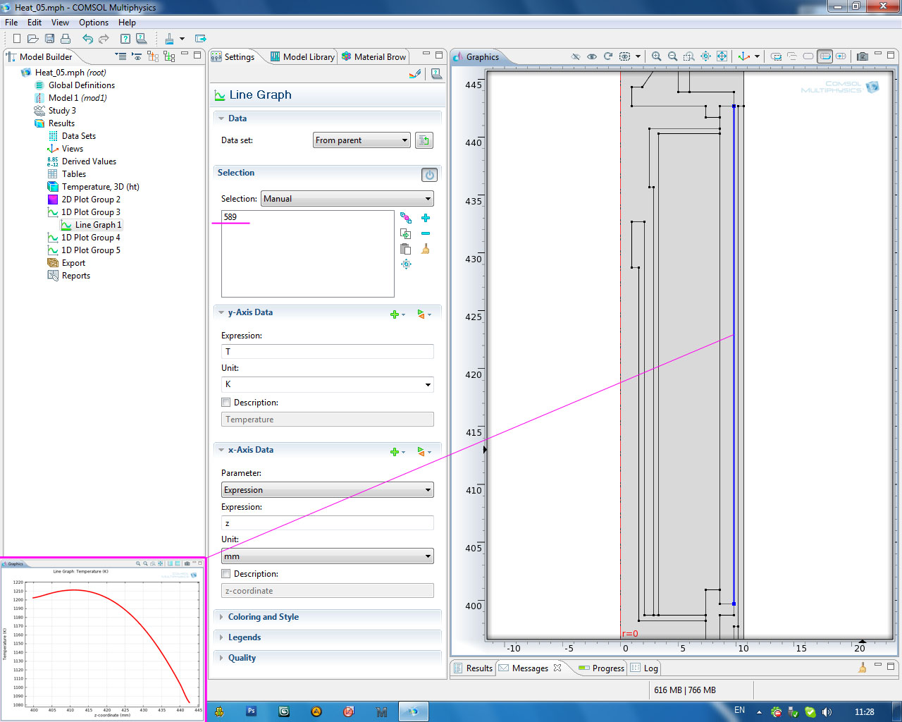

I have already got a temperature field of the model. How I can appropriate / set a variable for temperature distribution on border?

But the thing is that I don’t have to define the function T(z), as it is unknown in the very beginning – it can be acquired only as a result of calculation. I have to assign a variable to the still uncalculated temperature distribution on the element boundary. And then I'd like to use this variable for another function in a section (definition --> function), which depends on it.
